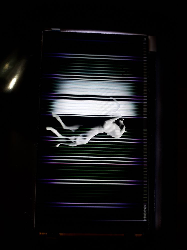

Hi everybody,
I'm making driver for a JDI 5" FHD display for TechNexion PICO IMX8MQ board. I use rm67191 as a reference (linux/panel-raydium-rm67191.c at tn-imx_4.14.98_2.0.0_ga-wip · TechNexion/linux · GitHub  and linux/fsl-imx8mq-evk-dcss-rm67191.dtsi at tn-imx_4.14.98_2.0.0_ga-wip · TechNexion/linux · GitHub  ) and linux-4.14.98.
Now the system can boot, but LCD doesn't work well. From the boot log (attached), I saw this line
[    1.319654] dcss-core 32e00000.dcss: Pixel clock set to 120000 kHz instead of 132000 kHz, difference is -12000000 Hz
It looks like the dcss automatically reduces the clock from 132MHz to 120MHz for some reasons.
I have tried to use 148.5MHz for pixel clock (change in device tree) and this time dcss reduces the clock to 135MHz.
I have tried with kernel version 4.14.78, but the problem still remains.
Is this an issue? And any suggestion about how to correct LCD timing? Thank you.

LinhNguyen
Hi igorpadykov,
Thank you for your reply.
I know the valid clocks list, and what I used is in the valid list (132MHz, 148.5MHz). But the actual clock isn't as set, it automatically changed to lower clock in the valid list (set 148.5, it changes to 135MHz; set 132MHz, it changes to 120MHz).

igorpadykov
Hi Linh
there are some clock limitations in mipi-dsi driver defined by "static int valid_clocks[]" in:
nwl-dsi.c\bridge\drm\gpu\drivers - linux-imx - i.MX Linux kernel
for setting necessary clock one can try workarounds suggested on
https://community.nxp.com/thread/513899
