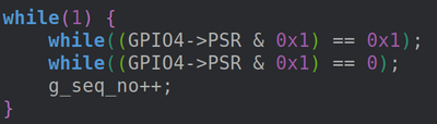

We wish to detect a 4MHz clock signal on one of the GPIOs by the M7 core to sample in data.
This is being done by reading IO0 of the GPIO4 peripheral.
Here is a snippet of some code we use to profile/test the detection of the clock signal:
What we find is that the M7 fails to accurately detect the signal running at 4MHz.
We can reduce the speed of the signal to toggle at 1MHz in which the M7 GPIO accurately detects the changes just fine, however Increasing the speed, we have problems when reading the GPIO Input signal.

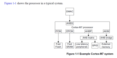

>More than an issue this seems that it is due to latency when accessing the GPIO register
Can you tell us how to configure the GPIO register read latency? Where is this documented? Could not find any thing in the TRM Manuals for the Cortex-M7 or iMX8MP. We are seeing it takes 60 Cortex-M7 Clock Cycles to read the GPIO registers which seems way too high.
Is it possible to reduce this number significantly by configuring the M7 Core differently?  For example by modifying the Memory Map. Like mapping the GPIO Registers into the Cortex-M7 Core internal address space using DMA or some other method?
Where can we find a list of the read latencies for accessing Cortex-M7 and iMX8MP peripherals across arbitration buses? Does NXP have any Application Notes on this topic?

Reference:
https://www.pjrc.com/teensy/DDI0489F_cortex_m7_trm.pdf
