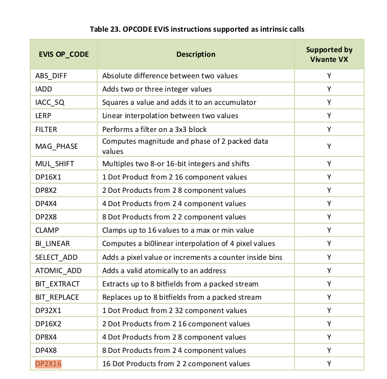

Meanwhile, checking the iMX Graphics User's Guide of the related BSP version shows that the above opcode is supported :

This document has information of differences between EVIS1 and EVIS2.
https://community.nxp.com/t5/i-MX-Processors-Knowledge-Base/OpenVX-Vision-Image-Extension-API-Introd...
Only EVIS1 supports instructions:
VXC_IAdd,VXC_MagPhase,VXC_BiLinear,VXC_SelectAdd,VXC_BitReplace,VXC_Filter,VXC_DP2x16/VXC_DP2x16_b

Hello khang,
i.MX8MP supports only EVIS2 instructions. The VXC_DP2x16/VXC_DP2x16_b is an EVIS1 instruction
