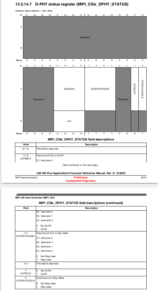

Dear Community,
We are facing a critical issue with custom iMX8MP based hardware comprising CPU/SoM board + Baseboard and dual camera board. With the same firmware (including same camera driver), we observe that :
1. Some combo works 10/10 with the the launching of individual pipeline of the dual camera configuration (i.e we tested 2 pipelines, each at a time).
2. Some combo works 9/10 or 10/10 for the 1st pipeline,  6/10 or 7/10 for the second pipeline.
3. Most of the rest of the hardware combo do not work at all.
We already ruled out the cause of :
a. Shared MCLK by adding a 24MHz oscillator fo each,
b. The incorrect power sequence of the sensor,
c. The timing of the power down signal of the sensor
Observation :
1. In the case of successful gst-launch (working) :
a. There was initial "Lost Frame Start Error" :

[ 3110.902414] mxc-mipi-csi2.0: --- mipi_csis_s_stream ---
[ 3110.902420] mxc-mipi-csi2.0:         CSIS_VERSION[0]: 0x03060301
[ 3110.902424] mxc-mipi-csi2.0:        CSIS_CMN_CTRL[4]: 0x00004905
[ 3110.902427] mxc-mipi-csi2.0:        CSIS_CLK_CTRL[8]: 0x000f0000
[ 3110.902433] mxc-mipi-csi2.0:          CSIS_INTMSK[10]: 0x0fffff1f
[ 3110.902437] mxc-mipi-csi2.0:          CSIS_INTSRC[14]: 0x00000000
[ 3110.902440] mxc-mipi-csi2.0:      CSIS_DPHYSTATUS[20]: 0x000000c0
[ 3110.902443] mxc-mipi-csi2.0:        CSIS_DPHYCTRL[24]: 0x05000007

2. In the case of unsuccessful gst-launch (not working) :gst-launch is pending and nothing (neither errors not status) is received :
[  332.732628] enter jxf355_query_capability
[  332.772212] enter isp_mi_stop
[  332.911221] enter jxf355_query_supports
[  332.911247] enter jxf355_get_clk
[  332.911259] enter jxf355_set_sensor_mode
[  332.911265] jxf355_set_sensor_mode: Setting mode 0
[  332.911272] enter jxf355_get_sensor_mode
[  332.911281] enter jxf355_query_supports
[  332.911406] enter isp_mi_stop
[  332.916892] enter jxf355_set_fmt
[  332.940073] enter jxf355_write_reg_arry
[  333.025824] jxf355_set_fmt: sync. registers before : 0xa7=00; 0x1e=04; 0x80=22
[  333.043601] jxf355_set_fmt: sync. registers after : 0xa7=00; 0x1e=18; 0x80=a2
[  333.043607] enter jxf355_get_format_code
[  333.043613] jxf355_set_fmt: sensor format = {.width=1920, .height=1080, .code=3007}

khang_letruong
Senior Contributor III
Hi again @joanxie ,
With the DPHY_STATUS register as below :
In the case of failure to capture, I observe that :
[  333.116101] mxc-mipi-csi2.1:      CSIS_DPHYSTATUS[20]: 0x000000c2
c2 = 1100 0010 ==> I think CSIS_DPHYSTATUS[1] should NOT be 1 during the streaming.  Do you agree? If yes, what caused this?
Khang
