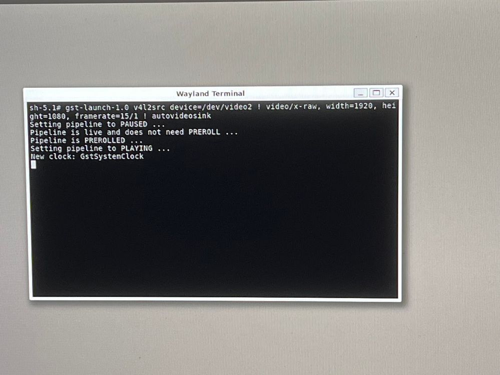

Hi NXP Community,
256MB of CMA memory has been successfully allocated in our iMX8M Plus based system with 1GB of DDR4:
root@viperimx8mp:~# dmesg | grep -i cma
[    0.000000] Reserved memory: created CMA memory pool at 0x0000000070000000, size 256 MiB
[    0.000000] OF: reserved mem: initialized node linux,cma, compatible id shared-dma-pool
[    0.000000] Memory: 703092K/1015808K available (17920K kernel code, 1506K rwdata, 6920K rodata, 2880K init, 553K bss, 50572K reserved, 262144K cma-reserved)
However, I am struggling with following errors while streaming the camera with gstreamer :
root@viperimx8mp:~# gst-launch-1.0 v4l2src device=/dev/video2 ! video/x-raw, width=1920, height=1080, framerate=15/1 ! autovideos
On the debug console side :
root@viperimx8mp:~# [  425.307460] enter isp_mi_stop
[  425.942933] enter isp_mi_stop
[  426.134422] cma: cma_alloc: alloc failed, req-size: 1013 pages, ret: -12
[  426.143351] cma: cma_alloc: alloc failed, req-size: 1013 pages, ret: -12
[  426.152091] cma: cma_alloc: alloc failed, req-size: 1013 pages, ret: -12
[  426.160775] cma: cma_alloc: alloc failed, req-size: 1013 pages, ret: -12
[  426.171442] cma: cma_alloc: alloc failed, req-size: 64 pages, ret: -12
[  426.178547] cma: cma_alloc: alloc failed, req-size: 1013 pages, ret: -12
[  426.189008] cma: cma_alloc: alloc failed, req-size: 1013 pages, ret: -12
[  426.199560] cma: cma_alloc: alloc failed, req-size: 1013 pages, ret: -12
[  426.209896] cma: cma_alloc: alloc failed, req-size: 1013 pages, ret: -12
[  426.251559] enter isp_mi_stop
[  426.381644] jxf355_set_fps : current frame length: 2252, current line length: 1280
[  426.399852] enter isp_s_comp
[  426.402763] enter isp_s_comp
[  426.405644] enter isp_s_comp
[  426.427504] enter wdr3_hw_init
[  426.430580] wdr3 res: 1920 1080
[  426.434753] enter isp_mi_start
Could you help if 256MB is sufficient for streaming single 1080p camera or the problem is somewhere else ?

Hi Khang,
I was facing same topic with my SoM. I found this link usefull
https://developer.toradex.com/software/linux-resources/linux-features/contiguous-memory-allocator-cm...
I assume it is controlled in the DTS in your case and you have to slightly increase your memsize.

khang_letruong
Senior Contributor III
Hi @Holger75 ,
Thanks for sharing your experience. I temporarily solved the issue by setting the CMA size to 512MiB, which is a half of the available DDR memory in the system. I am not sure if the remain 512MiB would be sufficient for other running stuffs.
