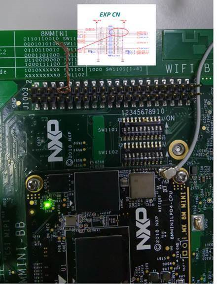

Hi Sir,
I have iMX8M mini EVK and I am able to connect my iMX8M mini to my laptop via USB Micro B debug port of iMX8 Mini. and i am bale to see the console output in putty / minicom.
from the documents i came to know that
The iMX8M has four independent UART Ports (UART1 – UART4).
But On the EVK board, only UART3 is available and the UART2 is used for Cortex-A53 core, and UART4 is used for Cortex-M4 core.
The Pin details for UART 3 is -
TXD   -   Pin 8
RXD   -   Pin 10
Now i want to test UART3 of iMX8M Mini.
I mean to say -
1. I want to connect iMX8M mini  USB Micro B debug port to my laptop and see the console.
2. Then I want to connect iMX8M mini UART3 to my laptop via some USB to serial convertor
3. Now I want to send some data say "Hello" to UART3 from my laptop and want to see this string in console / putty.
so basically i want to test UART3 TX and RX.
Please suggest me how can i do this or test UART3 .

BiyongSUN
It is very easy to test uart3 on i.MX8MM evk.  Just short the pin 8 and pin 10 on J1003
You can do the loop back test.

evk_8mm:/ $ su
evk_8mm:/ # stty -F /dev/ttymxc2 -echo
evk_8mm:/ # cat /dev/ttymxc2 &
[1] 4151
evk_8mm:/ # echo abcdef > /dev/ttymxc2
evk_8mm:/ # abcdef
evk_8mm:/ # ec[ 75.021722] healthd: battery l=85 v=3 t=35.0 h=2 st=2 c=400 fc=4000000 cc=32 chg=a
ho[ 76.603789] healthd: battery l=85 v=3 t=35.0 h=2 st=2 c=400 fc=4000000 cc=32 chg=a
fadsfasf13123432 > /et dev/ttym
ttymxc0 ttymxc1 ttymxc2
evk_8mm:/ # echo fadsfasf13123432 > /dev/ttymxc 2
evk_8mm:/ # fadsfasf13123432
evk_8mm:/ #
