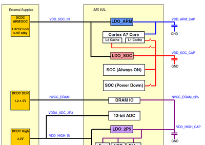

The IMX has two built-in LDOs (LDO_ARM, LDO_SOC).
Please let me know the maximum output current of each LDO.
We are trying to do PI analysis on our board, but I need this parameter.

The maximum load current of both LDO_ARM and LDO_SOC regulators of the i.MX6ULL processor is 250mA.
Artur
