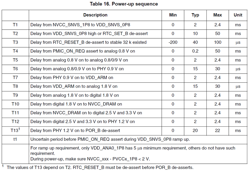

In the data sheet for the iMX8M Mini this table is given for the power up sequence:
Does this mean that if all the power rails are brought up simultaneously (as the minimum time for all rails to rail delays is 0ms) and then RTC_RESET_B is released some time later full and proper operation can be expected?
Likewise if all the rails are shutdown simultaneously will there be any adverse effects?
Many thanks

  Note, timings T1, T2, T3 are based on NVCC_SNVS_1P8 start moment,
but T4 - T13 are based on PMIC_ON_REQ, because t1 is uncertain period.
In both groups all voltages can start their rising simultaneously in the groups.
