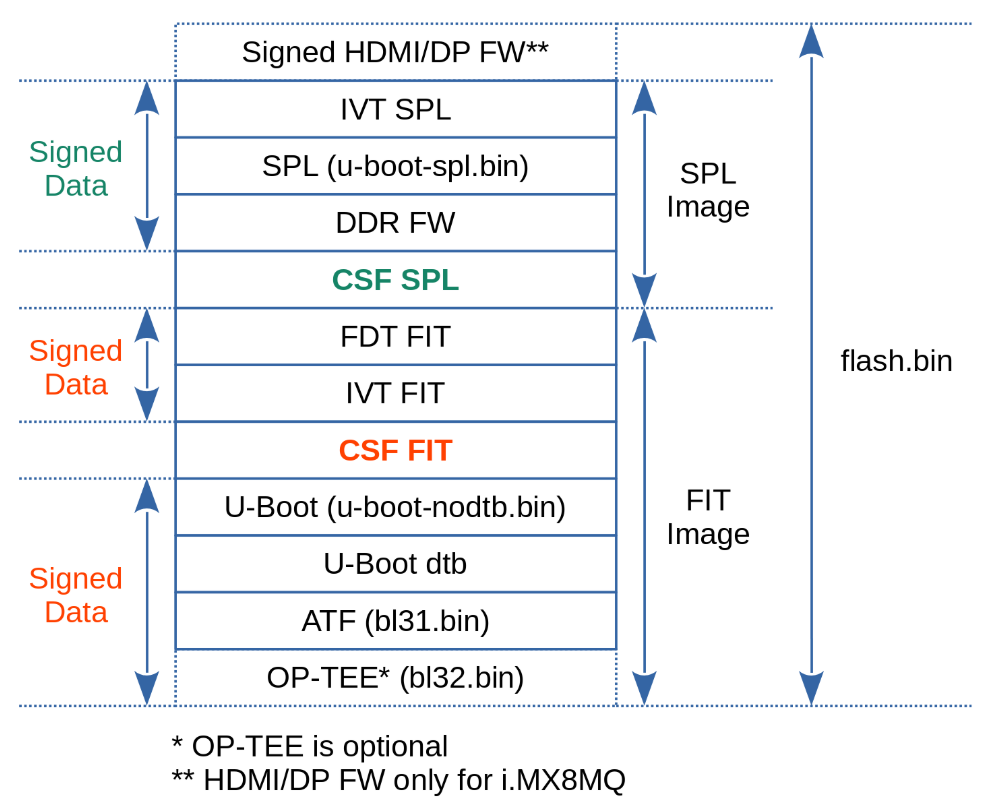

I'll start with the bottom line. I followed a document, received from NXP, for applying HAB on iMX8M processor. After updating the signed boot image and running "hab_status" command I receive the following:
Secure boot disabled
HAB Configuration: 0xf0, HAB State: 0x66
As you can see, on one hand I don't see any event printed but on the other hand I also don't see the  following typical message you see on a successful secure boot:
No HAB Events Found!
This leaves me with a question regarding the real status.
I must say that the document I'm following, seems to be in early stages of wring and far from a formal document you can find for iMX6, for example. In this document, there are references to figures that don't exist in the document. Some of the figures contain information that is referenced later. Specifically it can be found when generating CSF files and updating the relevant HAB blocks. I believe I was able to fill this gap of information, but there is some doubt here.
So to conclude:
1. Is it OK or not, that I don't see " No HAB Events Found!" message?
2. Do you have an updated and more complete version of the document?

So I've extracted HAB persistent memory (addres - 0x009061C0, size -0x0B80) and it seems like there is a single HAB event with the following Header and SRCE:
db 00 24 43 69 30 e1 1d
I parsed it using HAB4_API document under CST tool as follows:
Status = 0x69 --> HAB_WARNING
Reason = 0x30 --> HAB_ENG_FAIL (Engine failure)
Context = 0xe1 --> HAB_CTX_ENTRY (Event logged in hab_rvt.entry())
Engine = 0x1d --> HAB_ENG_CAAM (Cryptographic Acceleration and Assurance Module)
So it seems like there is an issue with the initialization of the HAB library done by hab_rvt.entry funcion.
It is as far as I can get for now but I still can't understand the issue.
I'd appreciate any comment on the new findings.
Thanks.

Hi Yuri,
Following is revision and CSF info:
CPU - Freescale i.MX8MQ rev2.0
Linux - 4.9.51-imx_4.9.51_imx8m_ga_var01+ga7188e8
U-Boot - 2017.03-imx_v2017.03_4.9.51_imx8m_ga_var01+g94b8909
CSF for FIT image:
[Header]
Version = 4.3
Hash Algorithm = sha256
Engine = CAAM
Engine Configuration = 0
Certificate Format = X509
Signature Format = CMS
[Install SRK]
File = "../crts/SRK_1_2_3_4_table.bin"
Source index = 0
[Install CSFK]
File = "../crts/CSF1_1_sha256_2048_65537_v3_usr_crt.pem"
[Authenticate CSF]
[Install Key]
Verification index = 0
Target index = 2
File = "../crts/IMG1_1_sha256_2048_65537_v3_usr_crt.pem"
[Authenticate Data]
Verification index = 2
Blocks = 0x40200000 0x5AC00 0x7A2F0 "flash.bin", \
0x910000 0xD4EF0 0xBED0 "flash.bin", \
0x0 0xE0DC0 0x0 "flash.bin", \
0x4027A2F0 0xE0DC0 0x61EF "flash.bin"
CSF for SPL image:
[Header]
Version = 4.3
Engine = CAAM
[Install SRK]
Source index = 0
[Install CSFK]
[Authenticate CSF]
[Install Key]
Target index = 2
[Authenticate Data]
Blocks = 0x7e0fd0 0x1a000 0x26400 "flash.bin"
Thanks.

eli2
Hi Yuri,
Returning back to this issue after some time...
I've taken the latest version of CST (3.1.0) but unfortunately I see the same results. I added some log messages in u-boot code to figure out what is happening and based on the outputs I understand that I probably have some HAB events, however it is failing to be reported. On hab.c, inside  the function hab_rvt_report_event there is a call to call_imx_sip that fails with error code 0x33 (HAB_FAILURE), and this aborts the report.
Do you have any idea or direction?
Thanks.
