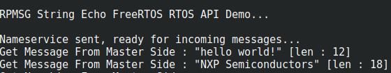

I have compiled and loaded the example into the CM4 processor. And after booting the EVK, and entered "modprobe imx_rpmsg_tty" at the command line of the A7 processor, I'm greeted with a message in serial terminal for the M4 saying:
Nameservice sent, ready for incoming messages...
Get Message From Master Side : "hello world!" [len : 12]

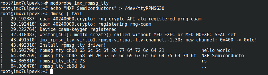

If I send another message using: "echo test > /dev/ttyRPMSG30" this message is also received by the M4 processor - but I would expect the message to be echoed back to the A7 processor.
I have tried "cat /dev/ttyRPMSG30" and also made a little script to read from the virtual port, but in either case nothing is returned. Am I reading the echoed message correct?

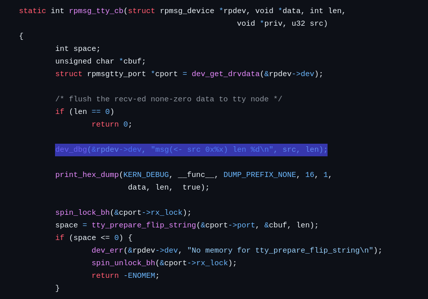

You can see in the Linux driver code the function rpmsg_tty_cb, that the received data will be printed on the Kernel debug:
I tested it by my side and this is my result:
CORTEX A side:
You can see I sent the text "NXP Semiconductors" to Cortex M, and Cortex M sent back the same message as you can see on the log from rpmsg_tty_cb driver.
And this is from Cortex M:

Thanks for the answer. It was the detail about printing of the echo in the kernel debug I was missing - now it is also working for me.
And also nice that you are pointing out in the driver code where the message it being printed out, since it might become useful later on, when I'm going to use this for communication between the two processors.
