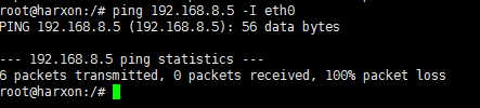

hi, all:
      the phy chip for our board is KSZ8081RNBIA1913A3M, now after kernel is loaded, the network is not working.
      the host (192.168.8.5) is my pc's address.

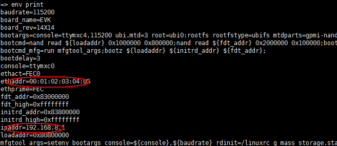

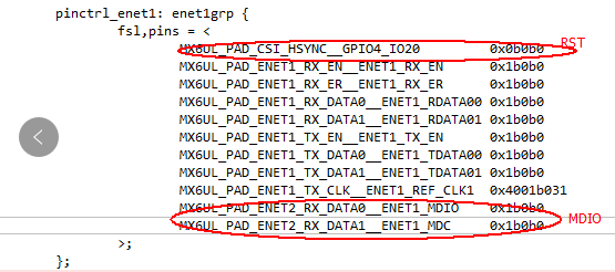

guochgz
Hi, igor.
      In my boards, We have checked that, our MDIO/MDC pins to change to ENET2_RX_DATA0/1, and RST pin changes to CSI_HSYNC(F3). INT pin keep the same, linked to the SNVS_TAMPER5.
   after above changes, we got log like this:
   libphy: Neil.zhang added here, addr = 2, phy_id = ffffffff
it seems that the KSZ8081 chip is not working or mdio dts configure err?

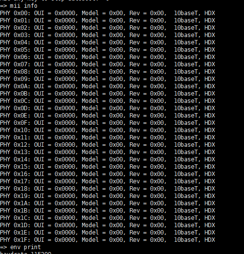

edit2:
      add some info that in uboot env.
Display: TFT43AB (480x272)
Video: 480x272x24
In: serial
Out: serial
Err: serial
Net: FEC0
Error: FEC0 address not set.
Normal Boot
Hit any key to stop autoboot: 0
=> mii info
PHY 0x02: OUI = 0x0885, Model = 0x16, Rev = 0x01, 100baseT, FDX
=> mdio read 0x1
Reading from bus FEC0
PHY at address 0:
1 - 0xffff
=> mdio read 0x2
PHY at address 0:
2 - 0xffff
=> mdio read 0x3
PHY at address 0:
3 - 0xffff
=> mdio
mdio - MDIO utility commands
Usage:
mdio list - List MDIO buses
mdio read <phydev> [<devad>.]<reg> - read PHY's register at <devad>.<reg>
mdio write <phydev> [<devad>.]<reg> <data> - write PHY's register at <devad>.<reg>
mdio rx <phydev> [<devad>.]<reg> - read PHY's extended register at <devad>.<reg>
mdio wx <phydev> [<devad>.]<reg> <data> - write PHY's extended register at <devad>.<reg>
<phydev> may be:
<busname> <addr>
<addr>
<eth name>
<addr> <devad>, and <reg> may be ranges, e.g. 1-5.4-0x1f.

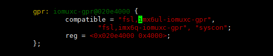

igorpadykov
Hi 国承 张
one can check enet clock with oscilloscope and debug it in function
setup_fec(int fec_id) paying attention to clock direction set by IOMUX_GPR1
mx6ullevk.c\mx6ullevk\freescale\board - uboot-imx - i.MX U-Boot
igor

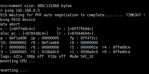

and in the file uboot/include/configs/imx6ullevk.h, I have change the CONFIG_FEC_ENET_DEV from 1 to 0. because on my board, there is only one phy for ENET1.
and after set env in uboot, this is no mii info on my board.
   and when I ping the host connected my board, the uboot reset...

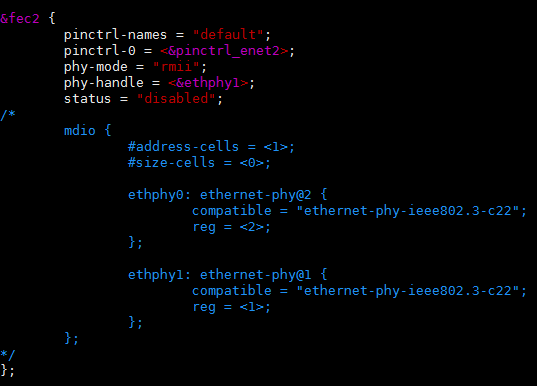

     in kernel. I have do some follow changes:
      and the left led of the RJ45 port is off status.
      is there any other suggestions?

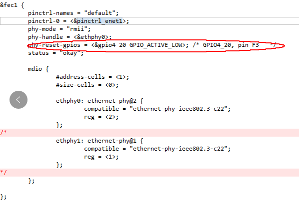

guochgz
Hi, igor.

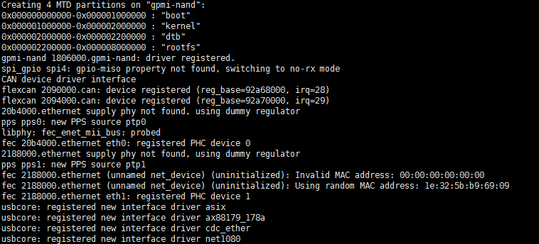

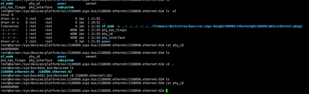

guochgz
yes, I have checked.
I have add some log in my baseline L4.1.15, found that phydev->phy_id is zero, does this means the phy chip is not work ?
fec 2188000.ethernet (unnamed net_device) (uninitialized): Invalid MAC address: 00:00:00:00:00:00
fec 2188000.ethernet (unnamed net_device) (uninitialized): Using random MAC address: 66:14:2a:50:c3:1a
Neil.zhang added here, before of_mdiobus_register
libphy: Neil.zhang added here, mido_register begin...
libphy: fec_enet_mii_bus: probed
libphy: Neil.zhang added here, phy_device_register
libphy: Neil.zhang added here, phy_scan_fixups
libphy: Neil.zhang added here, phy_uid = 221560, uid_mask = ffffffff
libphy: Neil.zhang added here, phy_id is 0, uid = 221560, uid_mask = ffffffff
libphy: Neil.zhang added here, phy_needs_fixup ret false, phy_uid = 221560, uid_mask = ffffffff
libphy: Neil.zhang added here, phy_uid = 221561, uid_mask = ffffffff
libphy: Neil.zhang added here, phy_id is 0, uid = 221561, uid_mask = ffffffff
libphy: Neil.zhang added here, phy_needs_fixup ret false, phy_uid = 221561, uid_mask = ffffffff
Neil.zhang added here, phy_device_register ret zero
mdio_bus 2188000.ethernet: registered phy ethernet-phy at address 2
mdio_bus 2188000.ethernet: registered phy ethernet-phy at address 1
another question ? what about you mean that check IOMUXC_GPR, I have no idea about that.
for full dmesg log, please refer to attachment.
