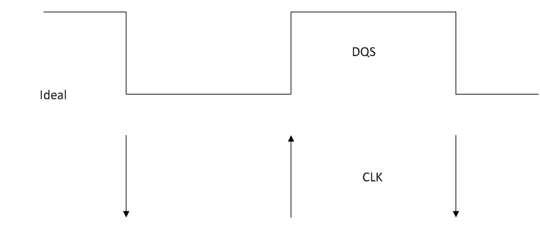

Data Write
The values DDR17 and DDR18 show the output valid times (output setup and output hold) for DQ.  This is showing up as 175ps for the setup and 200ps for the hold.  This is the output “valid” eye of 375ps.  Subsequently, 1250-375, or 875ps (70%!!) of the UI budget is consumed by the controller itself.  So given the 375ps valid eye, and the 125ps setup and 150ps hold requirement at the DRAM (See JEDEC JESD79-3F), it does leave only 375 – 125 – 150 = 100ps for everything else.  This seems highly unlikely.

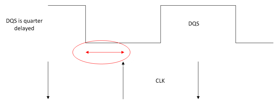

DQS-CK
The data sheet shows timing DDR21, tDQSS as being +/- 0.25 tCK.  Now, the DRAM has an input requirement with suspiciously the same name, tDQSS with the same requirement, +/- 0.25 tCK.  This is the requirement at the DRAM from the low-going DQS to the high going CLK. This means that the low going DQS can be no earlier than 0.25tCK from the high going tCK.  However, the controller’s uncertainty spec of DDR21 can only guarantee that the DQS can be within a quarter clock of the tCK.
So imagine the situation where the DQS is launched a quarter clock cycle late.  This means that the falling edge of the DQS is a quarter cycle before the CLK rising edge – at the output of the controller.
In this case, the DQS of the controller can be as little as a quarter cycle before the clock.  However, the tDQSS requirement at the DRAM is that the falling edge of the DQS is *at least* a quarter cycle before the rising clock.  This means that in the extreme situation, the controller gives the user zero margin for any PCB or other effects for a standard JEDEC compliant DRAM part!
My suspicion is that the data sheet has either been padded excessively, or has not been reviewed quite thoroughly.
