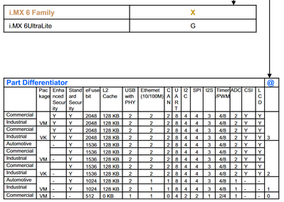

Unfortunately I don't have access an EVK at the moment so I can't test it immediately and I'm not sure if I will be able to find an EVK with the exact part number as my custom board.
Can you please confirm that my part number MCIMX6G0DVM05AB supports HAB and booting signed uboot?

igorpadykov
Hi Daniel
you are right, MCIMX6G0 does not support secure boot (HAB).
igor

danielberhe
Thank you for confirming this @igorpadykov.
Could you please tell me which document contains the information specifying which security features are supported on which part? I have signed the NXP NDA but would like to know which document to request from my NXP representative.
I am aware of the datasheet and that it specifies that no standard or enhanced security features are available for the part I'm using, but I couldn't find anywhere exactly what constitutes as standard or enhanced. I already have the security reference manual for the iMX6UL, but it doesn't mention any variation between different parts. I am keen to know the difference between 'no security', 'standard security', and 'enhanced security'.

igorpadykov
Hi Daniel
I am afraid such document is not available, sorry.
Previous answer was provided from internal team.

danielberhe
Thank you so much for all your help @igorpadykov.
I am changing the part on my board to MCIMX6G2CVM05AB. Could you please confirm that this part is capable of high assurance boot (signed uboot) and that I can use the CAAM module?

igorpadykov
yes this part supports secure boot (HAB).
