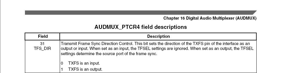

We referred the Reference manual sect.16.6.7 "Port Timing Control Register 4 (AUDMUX_PTCR4)" .
We set the AUDMUX_PTCR4 register to h'4210_8800 ".
AUDMUX_PTCR4 :
    TCSEL[3:0] - 1xxx Selects RXC from port.
    TFSEL[3:0] - 1xxx Selects RXFS from port.
As a result, the i.MX6 4-wire interface does not work correctly.

Hi koichi
if you selected in PTCR4 RXC, RXFS as inputs,
then RFSEL,RCSEL settings are ignored in PTCR4 -
TFSEL,TCSEL should be selected in appropriate PTCR1,2
register with TXC, TXFS configured in PTCR1,2 as outputs
and selection as you set:
igor
