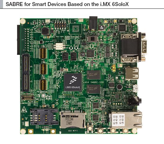

fmajeric
haha :smileylaugh:
I've made better, I changed the board !
I've invested into a Sabre-SD with an iMX6soloX embeded.
Thanks this Freescale board, I can use all Freescale tools (SDK, updated BSP, patches, etc...)
RIoTboard is usefull for some multimedia application but for specific hardware purpose, it's better to use manufacturer tools with adapted support.
Thank you for all you help.
Fabien.
