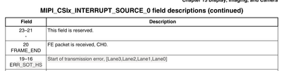

With iM8MP, we try convert HDMI input image data translate to mipi-csi, The MIPI host reports Start of transmission error, [Lane3,Lane2,Lane1,Lane0]
  • the log as below:
  • the manual interrupt description
  • Hardware Environment:

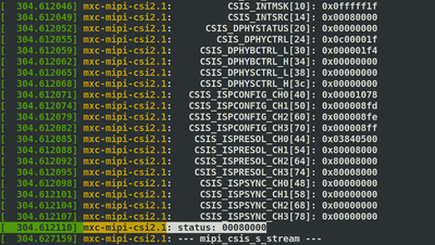

could you share the logfile? what's your mipi csi input resolution and clock ?

Please read the attach Doc and log, Have description the question and kernel log
Waiting for your help!
4,639 Views
joanxie
refer to your logfile, it seems this issue related to the clock issue, do you mind sharing the dts file? and try to use the command "v4l2-ctl --list-device" and "$ gst-launch-1.0 v4l2src device=/dev/video0 ! autovideosink"

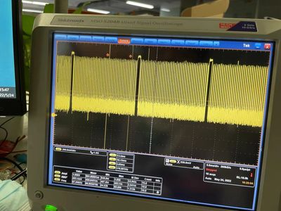

QiangF
@joanxie
Now we determine the MIPI output clock and data is correct
but imx8 can not receive the lanes data,
Please review  the attachment:DTS file
