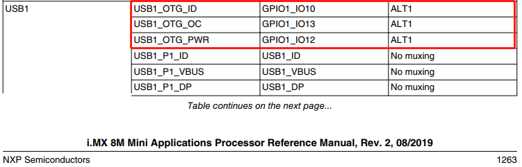

     I have some questions about USB design for i.MX8M Mini.
     Questions:
     1. What is the different function between USB1_OTG_ID and USB1_P1_ID ?  --《i.MX8M Mini Reference Manual》/P1263
     2. Can we read the status register for USBx_ID and USBx_VBUS ?
         Or, can we take USBx_ID and USBx_VBUS as GPIO that we can set them to generate interrupt ?
    3. In i.MX8M Mini demo schematic, we find USBx_OTG_ID、USBx_OTG_OC、USBx_OTG_PWR are not used, is that OK for USB2.0 OTG ?

Hi Jimmy,
See below, please!
USB1 has 2 IDs, one is USB1_OTG_ID, which is called GPIO ID. The other is USB1_ID, which is phy ID.
Yes.
No.
3.3. In i.MX8M Mini demo schematic, we find USBx_OTG_ID、USBx_OTG_OC、USBx_OTG_PWR are not used, is that OK for USB2.0 OTG ?

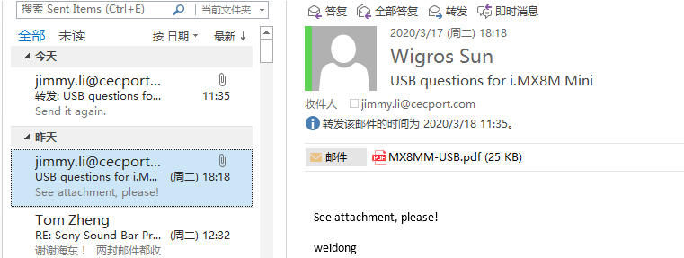

I drew a schematic for you as reference. it will be sent to your email, check it, please!

    Thanks for your reply.
    I haven't received the schematic yet, hope you can send to me ASAP.
