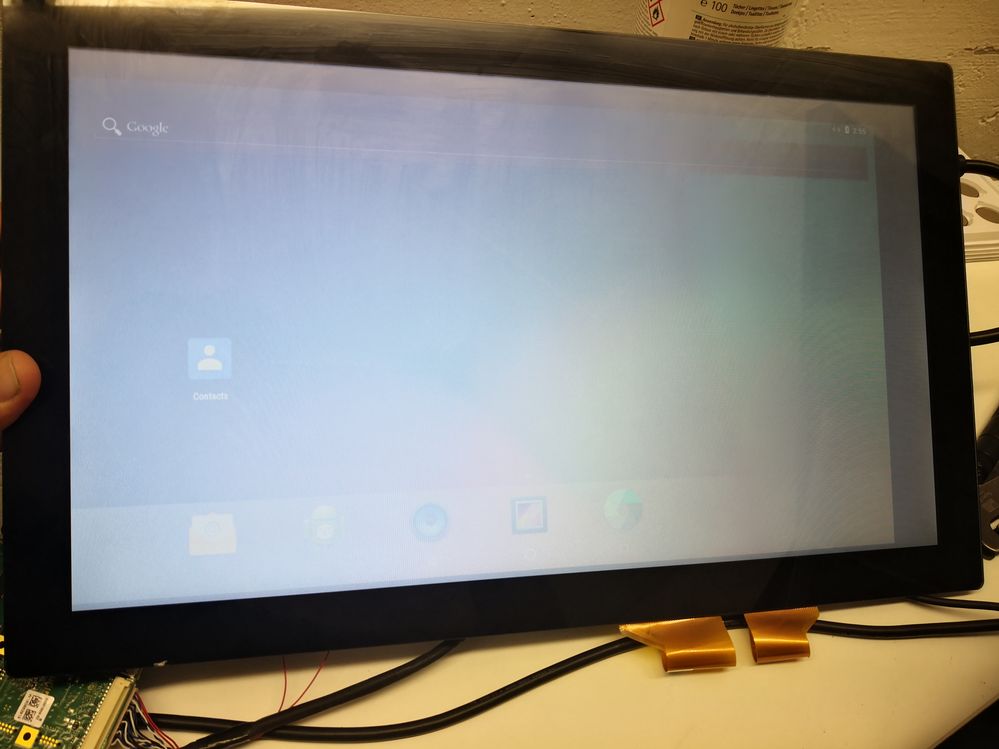

The Problem I'm facing is that on Android 4.4 the screen resolution fit perfectly, while on Android 8 it looks like this:
There is also a white glance to it.
when running on 4.4 (booted from the SDcard) it looks normal with vibrant colors, so a hardware issue is not causing this white layer
this is my override
setenv extra_bootargs video=mxcfb0:dev=ldb,bpp=16,if=RGB666 video=mxcfb1:off video=mxcfb2:off video=mxcfb3:off
 or
setenv video video=mxcfb0:dev=ldb,bpp=16,if=RGB666 video=mxcfb1:off video=mxcfb2:off video=mxcfb3:off
thanks

Hi wow, thanks for the fast reply
I think I burnt out the screen, it's now just a white screen

Hi William
one can try to adjust lcd timings ("display-timings") as in below example
https://variwiki.com/index.php?title=VAR-SOM-MX6_LVDS
