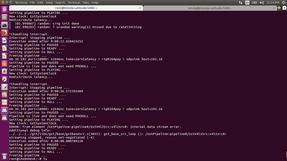

santhosh2
Dear members,
i.mx8mini supports 60fps but i get error when i give command $ gst-launch-1.0 v4l2src device=/dev/video1 ! 'video/x-raw, width=320,height=240,framerate=(fraction)60/1' ! textoverlay text=CAM1 font-desc=56 ! videoconvert ! x264enc tune=zerolatency ! rtph264pay ! udpsink host=192.168.36.102 port=10000
The error reported is internal data stream error:-pastedImage_1.png
Thanks and regards,
Santhosh

igorpadykov
Hi Santhosh
one can try decode example
gst-launch-1.0 filesrc location=file.mp4 ! video/quicktime ! qtdemux ! queue ! vpudec ! queue ! waylandsink sync=false
camera transcode:
gst-launch-1.0 v4l2src ! video/x-raw,format=NV12,width=1920,height=1080 ! queue max-size-time=0 ! vpuenc_h264 ! h264parse ! vpudec ! queue max-size-time=0 ! waylandsink enable-tile=true sync=false
igor

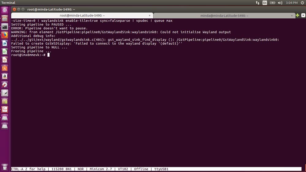

santhosh2
Hi igor,
I tried  $gst-launch-1.0 v4l2src ! video/x-raw,format=NV12,width=1920,height=1080 ! queue max-size-time=0 ! vpuenc_h264 ! h264parse ! vpudec ! queue max-size-time=0 ! waylandsink enable-tile=true sync=false
And got :-pastedImage_1.png

igorpadykov
Hi Santhosh
what camera are you using, could you try with Demo Image from
https://www.nxp.com/support/developer-resources/run-time-software/i.mx-developer-resources/i.mx-6ser...
is below pipeline working for you (MIPI CSI camera accessory; part number: MINISASTOCSI & MIPI DSI to HDMI Converter)
1080p @60 fps camera capture:
gst-launch-1.0 v4l2src device=/dev/video0 ! video/x-raw,width=1920,height=1080 ! waylandsink
igor
