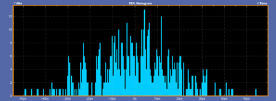

I read that the SN65DSI83 is quite sensitive to jitter, so I've tried to measure it. The measurement below is from the LVDS output.

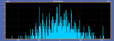

From the DSI clock generated by the NXP chip:
I've tried three different crystals and oscillators for the 24MHz clock and none of them gave any improvement.
I tried using a 25MHz oscillator on the TI chip's REFCLK pin as an alternative to using the DSI clock, and the jitter is much improved and the problem seems to have gone away. The below screenshot is of the LVDS output jitter.
I don't understand why the jitter is higher when using the DSI clock. It seems that I might be able to forego having to add the REFCLK oscillator if I can reduce the jitter of the DSI clock, or maybe the jitter is a 'red herring' and something else is causing the issue when using the DSI clock? It would be good to learn what causes this problem and maybe avoid having to rework a number of boards to add the REFCLK oscillator.

I've found two solutions which appear to fix the problem:
1. Use an external 25MHz oscillator connected to the REFCLK pin of the SN65DSI83. This has the disadvantage that it doesn't work if spread spectrum is enabled on the video clock above 1% and it requires extra parts to be fitted to the PCB but seems to be reliable.
2. Use the video PLL for the ESC Clock and the DPHY Reference Clock instead of PLL_528. This is configured in display_support.c. There is no need to use the REFCLK oscillator in this case and it appears to work with higher levels of spread spectrum too but further testing will be needed to verify that. It is certainly a lot more reliable than when using PLL_528.
