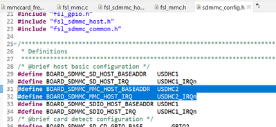

ramreddy
I had
1. added eMMC connected uSDHC2 channel in sdmmc_config.h file. The below changes are done to select the eMMC.
2. Enabled uSDHC2 channel in peripheral configuration section. The below pins I had configured for eMMC.
3. Modified mmccard_init(mmc_card_t *card) function for handling the EXT_CSD issue in the file fsl_mmc.c. I had shared the source code with you already kindly refer the respective function.
Ramreddy.
