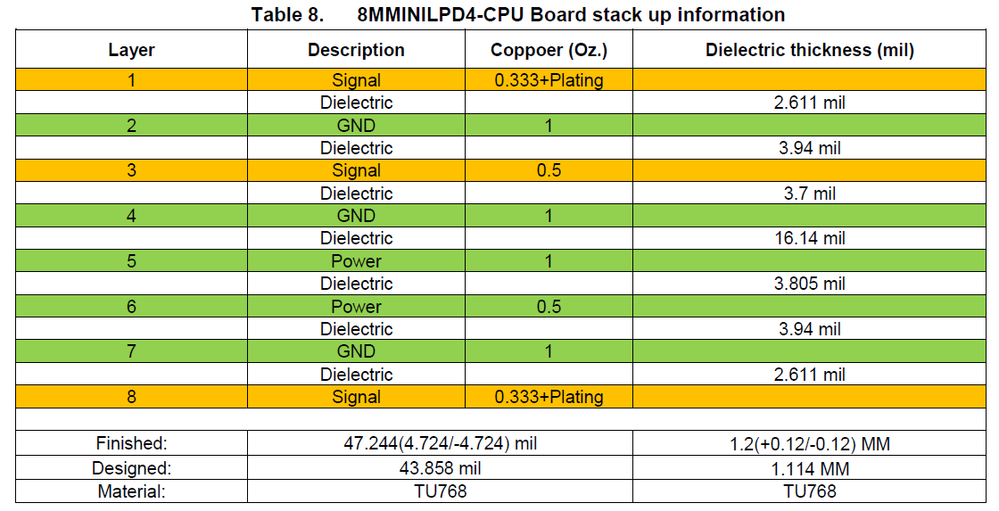

In the i.MX8M Mini EVK hardware user guide, section 3, table 8 shows the stackup as:
      Figure 1

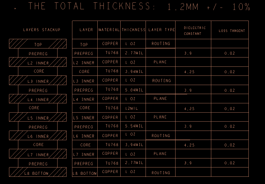

In the PCB layout file, the stackup is shown as:
Figure 2
What is the reason for difference in some of the layer thickness? Also, is it safe to assume, the PCB layout stackup (Figure 2) is the correct one?

The correct one should be the figure 2,
the figure 1 is just a guideline of how the board could be made.
