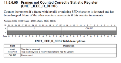

Hi Igor,
In this case, the 100M is working fine but 1g is not working (We have connected the MAC to MAC directly between two processors). The error we are getting here the ENET_IEEE_R_DROP packets with 1g.
 Regards.

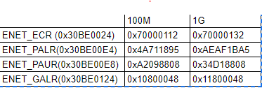

harshitshah
Hi Igor,
Thank you for your reply. I have gone through the code and checked for the configuration register map for the ENET Section for 1G and 100M speeds.
  1. Please find attached the configuration register settings for 1G and 100M. It looks like the register settings for the configuration are proper for 1G, however still not able to get the 1G speed working. Do you think any changes required in the configuration from the attached settings?
  2. We have probed the hardware and checked that there are signals on lines but we are not receiving anything from the software front. Do you think this is a hardware issue? We have submitted the schematics, signal net-length report in the main email chain.
Regards.
30,283 Views
igorpadykov
Hi harshitshah
regarding configuration register settings - you can test with i.MX8MQ EVK conected to
PC computer and dump register values, then compare them with custom case.
