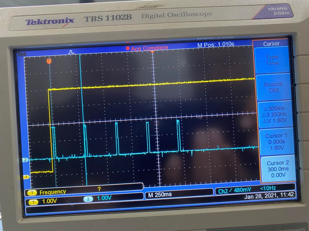

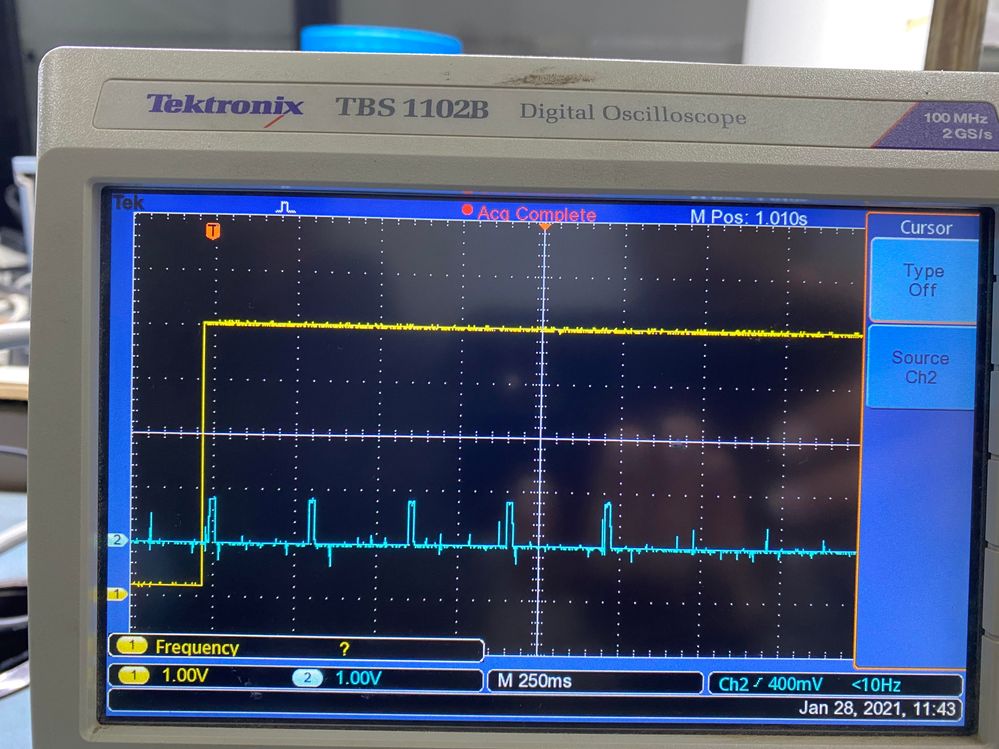

We have measured WDOG_B Voltage in MPU Side when it is disconnected from PMIC, It is 0V and pmic is not generating output other than LDO1 and LDO2.
And we measured LD02 Voltage is 0.9v Instead of 0.8V, can this affect on pmic_on_req signal or any other interface/Blocks of MPU?
When pmic_on_req is connect than and than the pmic buck and ldo voltage are not generate and it gives 5 pulses at 300ms interval and on for 20ms.
Please find attached images. second image is Showing waveform of PMIC_5V (Yellow Channel) vs PMIC_ON_REQ(Blue Channel) and first image is Showing waveform of PMIC_5V(Yellow Channel) vs LDO2_Out(Blue Channel) of PMIC. Same waveform is arrive on LDO1.
May be PMIC Start the ldo1 and ldo2 & MPU start pmic_on_req, but due to some bad configuration/something else it goes low.
pmic_vsys_5V Vs LDO2 Outputpmic_vsys_5V Vs LDO2 Outputpmic_vsys_5V Vs PMIC_ON_REQpmic_vsys_5V Vs PMIC_ON_REQ
Hope you got my point, please help me out in this problem.
