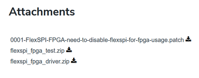

2,523 Views
Chavira
Hi @vdoser!
Thank you for contacting NXP Support!
You can download all the files of this article at the bottom of the page (see attached image)
If you have questions about the compilation of the kernel I recommend reading our Linux Documentation:
https://www.nxp.com/design/software/embedded-software/i-mx-software/embedded-linux-for-i-mx-applicat...
Best Regards!
