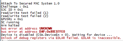

To use Secure jtag, I referred to document AN4686 (Secure Debug in i.MX 6/7/8M Family of Applications Processors).
# Environment
The working environment uses imx8mp SoC, and Trace32 uses the 2023/02 version.
# eFusing
and, The efusing proceeded as follows.
- SJC_RESP (*imx8mp has 128 bits unlike other SoCs)
fuse prog 8 0 0x55aa1234
fuse prog 8 1 0x00aa5533
fuse prog 15 1 0x55aa1234
fuse prog 15 2 0x00aa5533
- Burn SJC_RESP_LOCK (<- Is it a must-have when testing?)
fuse prog 0 0 0x400
- Burn JTAG_SMOD
fuse prog 1 3 0x400000
# trace32 - script
- The test was conducted with imx8m script and im6 script.
1. imx8m script (T32\demo\arm\hardware\imx8\imx8m\secure-jtag\attachimx8m.cmm)
: Regardless of whether the response value is modified or not, the message "Keyword is too long" occurs and the script does not run normally.
2. imx6 script (T32\demo\arm\hardware\imx6\secure-jtag\attachimx.cmm)
: It doesn't give me the same error as the imx8m script, but it doesn't seem to work.
: Values such as Challenge and SJC ID do not seem to be read normally.
: A "read/write test failed" message appears.
2-1. The response value was modified to match the efusing value. (64bit)
ENTRY &challenge
&response=0x00aa553355aa1234
ENDDO &response
: But I'm still having problems. So I tried inputting the entire 128bit instead of 64bit.
2-2. The response value was modified to match the efusing value. (128bit)
ENTRY &challenge
&response=0x00aa553355aa123400aa553355aa1234
ENDDO &response
: However, an error occurred because the size of the response variable could not accept 128 bits.
Can you tell me what's wrong?

I tested with 2 cases (imx6, imx8m).
Each script was based on the demo script supported by T32, and the encrypted *.cmmx file was not touched.
1. Base: T32\demo\arm\hardware\imx6\secure-jtag
1-1. attachimx.cmm
RESET
AREA
SYStem.CPU iMX8MQ
CORE.ASSIGN 1
SYStem.Option ResBreak OFF
SYStem.Option WaitReset 1.3s
Trace.METHOD Onchip
; deprecated SYStem.MultiCore.tristate OFF
SYStem.CONFIG.TriState OFF
DO ~~~~/imx6_attach_secured.cmmx ENRESET=OFF
SYStem.JtagClock 10MHz
SYStem.Mode Attach
IF STATE.RUN()
Break
ENDDO
1-2. calculateresponse.cmm
ENTRY &challenge
&response=0x00aa553355aa1234 ;
ENDDO &response
2. Base: T32\demo\arm\hardware\imx8\imx8m\secure-jtag
2-1. attachimx8m.cmm
RESet
SYStem.RESet
SYStem.CPU IMX8MQ
SYStem.JtagClock CTCK 10MHz
SYStem.Option WaitIDCODE 1.5s
CORE.ASSIGN 1.
Trace.DISable
SYStem.Mode Prepare
DO ~~~~/imx8m_attach_secured.cmmx
;CORE.ASSIGN 1.
SYStem.Mode Attach
IF RUN()
  Break
ENDDO
2-2. calculate_response.cmm
PRIVATE &nChallenge &nResponse
PARAMETERS &nChallenge
&nResponse=0xaa553355aa1234 ;
;&nResponse=0x55aa1234aa5533 ;
ENDDO "&nResponse"

However, when executing the provided script, unfortunately, it is not possible to perform the attach for debugging successfully.
I was able to confirm that reading the Challenge value is functioning correctly. (However, I'm not sure where to read the SJC ID and what it signifies.)
As for the response value, I have modified the script based on the values I wrote. (Just to mention again, the imx8mp soc has a total of 128 bits in the response value.)
Other than the response value, no separate modifications were made, and when running the script, I confirmed that it is still not possible to perform the attach as before.
Am I missing Somthing?
