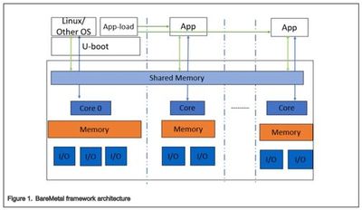

igorpadykov
Hi Waseem
from team:
Based on your requirement that "Our goal is to run a bare-metal code on one of the A53 cores",
We recommend to use Real_Time_Edge released by NXP, rather than through a startup script.
https://www.nxp.com.cn/design/software/development-software/real-time-edge-software:REALTIME-EDGE-SO...
https://www.nxp.com.cn/docs/en/user-guide/REALTIMEEDGEUG.pdf
Page 23 of Real-time Edge Software User Guide has the introduction of BareMetal framework.
3.2 BareMetal
The main features of the BareMetal framework are as follows:
• Core0 runs as master, which runs the operating system such as Linux, Vxworks.
• Slave cores run on the BareMetal application.
• Easy assignment of different IP blocks to different cores.
• Interrupts between different cores and high-performance mechanism for data transfer.
• Different UART for core0 and slave cores for easy debug.
• Communication via shared memory
