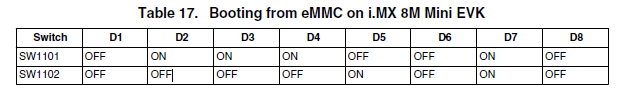

Hi Supporter,
We build a yocto project by using MACHINE=imx8mmddr4evk.
Try to use UUU to flash imx-boot-imx8mmddr4evk-sd.bin-flash_ddr4_evk & imx-image-core-imx8mmddr4evk-20201201043011.rootfs.wic.
At end of log, it shows "MMC card init failed". Can you advise why this happened or how to fix it?
PS: Please check attached for boot config.

Can you use this command in shell to try again ?Put the uuu.exe into deploy folder.
uuu -b emmc_all imx-boot-imx8mmevk-sd.bin-flash_evk imx-image-full-imx8mmevk.rootfs.bz2

  1. We modify u-boot device tree to solve “MMC card init failed!” issue and UUU can flash image successfully now.
  2. Switch boot mode to eMMC boot.
  3. Power on/off DUT and it will hang up at u-boot.
LOG:
U-Boot SPL 2019.04-lf-5.4.y_v2019.04+g48508669 (Dec 02 2020 - 02:47:35 +0000)
power_pca9450_init
DDRINFO: start DRAM init
Training FAILED
DDRINFO:ddrphy calibration done
DDRINFO: ddrmix config done
Normal Boot
Trying to boot from MMC2
MMC Device 1 not found
spl: could not find mmc device 1. error: -19
SPL: failed to boot from all boot devices
    4. Try to debug in u-boot via UUU.
u-boot=>
u-boot=> mmc list
FSL_SDHC: 2
u-boot=> mmc dev 1
no mmc device at slot 1
u-boot=> mmc dev 2
switch to partitions #0, OK
mmc2(part 0) is current device
u-boot=>

You can use  prebuilt images in our website for test.Normally, the boot process has no problem.You must set correct boot config like following picture.Snipaste_2020-12-02_15-11-29.pngSnipaste_2020-12-02_15-11-29.png
The download command is "uuu -b emmc_all imx-boot-imx8mmevk-sd.bin-flash_evk imx-image-full-imx8mmevk-20200708060549.rootfs.bz2".

Please check the sw1 &sw2 is correct according to the table in the upper left corner of board.Can you put your uuu command?
