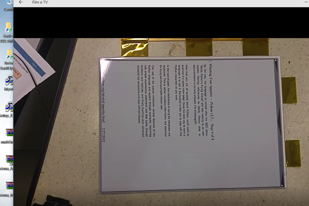

Hello gusarambula,
my problem is a bit different:
just renaming the Firmware epdc_ED060XH2C1.fw supplied with the Sabre board to epdc_ED133UT2.fw and making the above modification to the Kernel
static struct fb_videomode config2_mode = {
.name="ED133UT2",
everything works quite well
 Only if I run the test
mxc_epdc_v2_fb_test.out -n 18
some characters of the text have less contrast than the nearby ones.

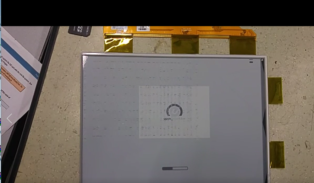

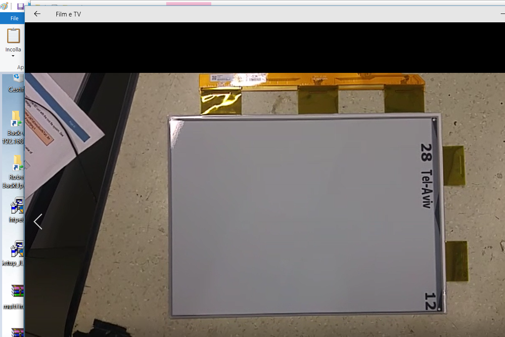

Instead if I work with the correct fw file for ES133UT2 given to me by the local NXP FAE I have the following problems:
-At the boot the edpc display is cleared but the splash image is not drawn
-the splash image is drawn  the first time I run the  epdc test program or my epdc program
-the clear function doesn't work:each new image is superimposed on the previous one
-I changed the num_ce parameter (from 1 to 2,3..)but I did not see any improvements
-I tested different versions of the kernel (krogoth L4.1.15_2.0.1 and morty L4.1.15_2.1.0) but I obtaneid the same results: ES133UT2 working quite well with the wrong Firmware and not working with the correct one.

Instead if I upload to /lib/firmware/imx/epdc the fw file received by local NXP FAE  "320_R118_AD5B01_ED133UT2C1_TC.fw"
(size 1023734 bytes) and I set the parameters of the mxc_epdc_v2_fb.c file following the   community.nxp.com/thread/457285 always get all the problems described above:
Here the not working set of  mxc_epdc_v2_fb.c  file:

I modified the num_ce parameter from 1 to 2,3.. but I didn't see any improvement.
It could not be that the Firmware "320_R118_AD5B01_ED133UT2C1_TC.fw" was only tested with the A9 imx6 and not with A7of  imx7D?
