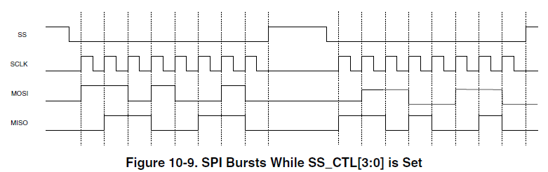

I'm trying to implement a driver for an SPI peripheral. The code would be executed in M4. I'm using the Sabre board Rev B
The peripheral requires the data in a format of 9-bit words, the first bit is a control bit followed by eight data bits. The Chip Select signal must be active diring the whole data transfer.
For that, I need to have burst length of 9 bits. (BURST_LENGTH = 8). The behavior of the Chip Select should be controlled by SS_CTL. My problem is that SS_CTL has no effect on the behavior of the Chip Select.
I have set SMC (Start Mode Control) to zero, as suggested by the reference manual. After that I write four 9-bit words to TXFIFO and start the burst with writing to XCH. This sends the first 9-bit burst and negates the Chip Select back to inactive. After Writing to XCH three more times, all data is sent, but the Chip Select signal negates between all bursts.
This (Figure 10-8) is what I expect, with 9-bit words:
But this (Figure 10-9) is what I get, regardless of the position of SS_CTL bits
In Linux this seems to work. However, I haven't checked, is the Chip Select implemented by SW or by HW.

danhagler
I mean that I set BURST LENGTH to something < 31 (bits < 32), say BURST LENGTH = 8 (9 bits), and load multiple 32 bit values into the TX FIFO, say 3 wrties to the TXDATA register of 0x00000101, 0x000001F2, 0x000001E3, then set XCH to 1. With SS_CTL = 0, only the first 9 bit word, 0x101, is transmitted.
For SS_CTL = 1, all 3 words of 9 bits are sent. With SS_CTL = 1, chip select active during each 9 bit word transmission and inactive between each 9 bit word, as expected.
BURST LENGTH = 8
SS_CTL = 1
TEEN = 1
TE interrupt - write 0x00000101 to TXDATA, write 0x000001F2 to TXDATA, write 0x000001E3 to TXDATA
CS active, 9 bits 0x101, CS inactive, CS active, 9 bits 0x1F2, CS inactive, CS active, 9 bits 0x1E3, CS inactive.
TE interrupt - signal complete semaphore
Success!
For SS_CTL = 0, only 1 word of 9 bits are sent, chip select is held active indefinitely and the TX FIFO has 2 words waiting to be sent, but they are not sent. I expected all 3 words of 9 bits to be sent, as happens when SS_CTL = 1. The only difference of behavior I expected is that chip select would remaining active across the transmission of all 5 words of 9 bits.

Yuri
   You may get operations as shown on the Figure 10-8 (SPI Burst While SS_CTL[3:0] is Clear)
of the RM (Rev. 0.1, 08/2016), but please take into account, that the description under the figure
is not fully correct. "The maximum length of a single SPI burst is defined in the BURST LENGTH
field of the ECSPI_CONREG control register".  Really the maximum length of the single SPI burst
is defined by FIFO. When FIFO is overflowed the SS is negated.
Yuri.

  According to SS_CTL bit field description, when SS_CTL= 0 : in master mode - only one SPI burst
will be transmitted (without CS negation), assuming transfer total number of bits / words, configured
via  BURST_LENGTH.

  To transfer N 9-bit words it is needed to set BURST_LENGTH, assuming that burst is N * 9 bit,
and pack the data to the FIFO with 32-bit port.
Yuri.
