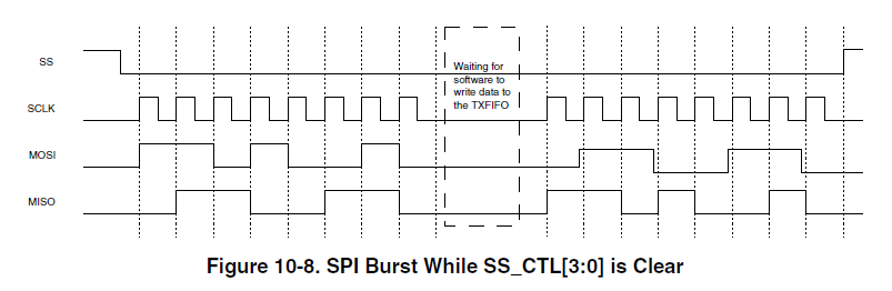

I'm trying to implement a driver for an SPI peripheral. The code would be executed in M4. I'm using the Sabre board Rev B
The peripheral requires the data in a format of 9-bit words, the first bit is a control bit followed by eight data bits. The Chip Select signal must be active diring the whole data transfer.
For that, I need to have burst length of 9 bits. (BURST_LENGTH = 8). The behavior of the Chip Select should be controlled by SS_CTL. My problem is that SS_CTL has no effect on the behavior of the Chip Select.
I have set SMC (Start Mode Control) to zero, as suggested by the reference manual. After that I write four 9-bit words to TXFIFO and start the burst with writing to XCH. This sends the first 9-bit burst and negates the Chip Select back to inactive. After Writing to XCH three more times, all data is sent, but the Chip Select signal negates between all bursts.
This (Figure 10-8) is what I expect, with 9-bit words:
But this (Figure 10-9) is what I get, regardless of the position of SS_CTL bits

Questions:
- Is there something wrong with my configuration, or is the HW working incorrectly? Of course the SW developers tend to blame HW rather than own code.
- Should Writing to XCH transfer all words that are in TXFIFO or just the first one, like in my case?

I got my workaround working. I extended the burst length to contain the total number of bits in the data (multiple of 9 in my case) and implemented a lot of bitwise operations to get all 9-bit words one after another.
But this question is still unanswered: How can I get chip select behavior like in figure 10-8 with BURST_LENGTH=8?

  The eCSPI supports single SPI bursts with multiple BURST LENGTH words, assuming that
in the case, when BURST LENGTH is greater than 32, full 32-bit word(s) from FIFO will be sent,
except the recent one.

I mean that I set BURST LENGTH to something < 31 (bits < 32), say BURST LENGTH = 8 (9 bits), and load multiple 32 bit values into the TX FIFO, say 3 wrties to the TXDATA register of 0x00000101, 0x000001F2, 0x000001E3, then set XCH to 1. With SS_CTL = 0, only the first 9 bit word, 0x101, is transmitted.
For SS_CTL = 1, all 3 words of 9 bits are sent. With SS_CTL = 1, chip select active during each 9 bit word transmission and inactive between each 9 bit word, as expected.
BURST LENGTH = 8
SS_CTL = 1
TEEN = 1
TE interrupt - write 0x00000101 to TXDATA, write 0x000001F2 to TXDATA, write 0x000001E3 to TXDATA
CS active, 9 bits 0x101, CS inactive, CS active, 9 bits 0x1F2, CS inactive, CS active, 9 bits 0x1E3, CS inactive.
TE interrupt - signal complete semaphore
Success!
For SS_CTL = 0, only 1 word of 9 bits are sent, chip select is held active indefinitely and the TX FIFO has 2 words waiting to be sent, but they are not sent. I expected all 3 words of 9 bits to be sent, as happens when SS_CTL = 1. The only difference of behavior I expected is that chip select would remaining active across the transmission of all 5 words of 9 bits.

   You may get operations as shown on the Figure 10-8 (SPI Burst While SS_CTL[3:0] is Clear)
of the RM (Rev. 0.1, 08/2016), but please take into account, that the description under the figure
is not fully correct. "The maximum length of a single SPI burst is defined in the BURST LENGTH
field of the ECSPI_CONREG control register".  Really the maximum length of the single SPI burst
is defined by FIFO. When FIFO is overflowed the SS is negated.

If your answer is correct, I don't get, what's the point of SS_CTL. The reference manual states the following:
"When the SPI SS Wave Form Select (SS_CTL[3:0]) is set, the current operation is multiple bursts transfer. When the SPI SS Wave Form Select (SS_CTL[3:0]) bit is cleared, the current operation is single burst transfer. A SPI burst can contains multiple words as defined in the BURST LENGTH field of the ECSPI_CONREG register."
and further:
"In Figure 10-8, two 8-bit bursts in the TXFIFO have been combined and transmitted in one SPI burst. The maximum length of a single SPI burst is defined in the BURST LENGTH field of the ECSPI_CONREG control register. (Figure 10-8 corresponds to a BURST LENGTH of 8.) This provides a way for transferring a longer SPI burst by writing data into TXFIFO while the ECSPI is transmitting."
and even further, SS_CTL is described as following in ECSPIx_CONFIGREG field descriptions:
SPI SS Wave Form Select. In master mode, this field controls the output wave form of the Chip Select (SS) signal when the SMC (Start Mode Control) bit is cleared. The SS_CTL are ignored if the SMC bit is set.
Thus: it should be possible to write nine-bit words to TXFIFO and let HW take care of the rest so that result is one single burst with SS not negating in between. Currently SS_CTL has no effect on the SPI behavior in master mode.
So, I think I need the function of SS_CTL explained a bit more. I still believe that the HW should work as described in the reference manual, or this should be fixed in errata. The reference manual is not just "not fully accurate", but the whole paragraph is totally incorrect, if the behavior is as you mentioned.

  According to SS_CTL bit field description, when SS_CTL= 0 : in master mode - only one SPI burst
will be transmitted (without CS negation), assuming transfer total number of bits / words, configured
via  BURST_LENGTH.

Thanks a lot for your response. That answered to the second part of my question. Having SS_CTL= 0 should transfer only one burst, not all the words that are in TXFIFO.
But, there's yet the first part - the more important part unanswered: how do I get signal that is illustrated in figure 10-8? I have set SS_CTL= 0, BURST_LENGTH = 8 and SMC=0. Still I get Chip Select signal behave like in figure 10-9. It negates between all bursts.

  To transfer N 9-bit words it is needed to set BURST_LENGTH, assuming that burst is N * 9 bit,
and pack the data to the FIFO with 32-bit port.
Yuri.

I don't think that the buffer conversion should be necessary according to the documentation. i.MX7 reference manual states: "Figure 10-8 corresponds to a BURST LENGTH of 8". Thus; it should be possible to stack 9-bit words to TXFIFO and let the processor to handle the rest. Conversing long 8-bit data buffers to 9-bit format with command bits in front is quite a CPU intensive task.
