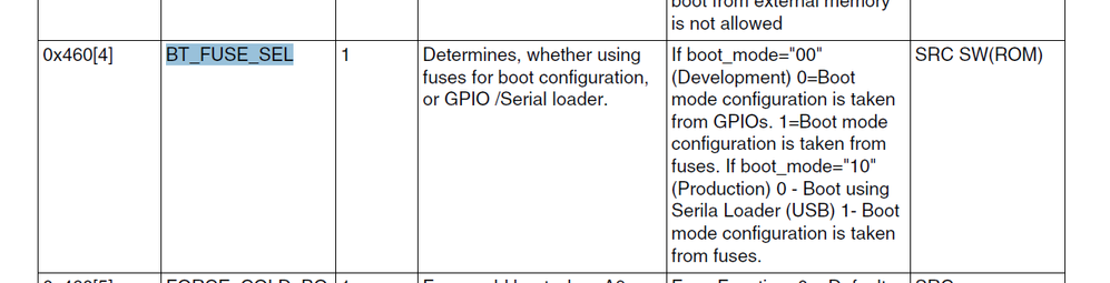

2)refer to the reference manual, if internal boot failed, the boot code jumps to the download mode
"The boot code performs the hardware initialization, loads the program image from the
chosen boot device, performs the image validation using the HAB library , and then jumps to an address derived from the program image. If an error occurs during the internal boot, the boot code jumps to the Serial Downloader"
you also can refer to the BT_FUSE_SEL
more detailed information, pls refer to the reference manual
