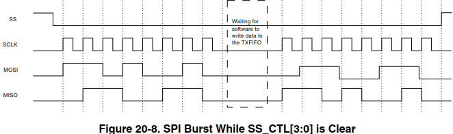

In i.Mx6ULL reference manual.
1. For single burst. Is it mean transfer single FIFO and waiting for software to write data to FIFO? SS is an don't care pin, until FIFO transfer complete?

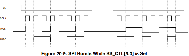

2. For multi burst. Is it mean transfer different FIFO, SS pin will assert if any FIFO transfer complete? Then transfer another FIFO? The burst won't finish until all FIFO transfer complete?

Yuri
  For the first case the maximum length of the single SPI burst is defined by FIFO. When FIFO is
underflowed (empty) the SS is negated.  ECSPIx_PERIODREG may be used to setup delays between
SPI transfers.
  For the second -  multiple words, as defined in the BURST LENGTH field of the ECSPI_CONREG register,
will be transferred with SS negation.
