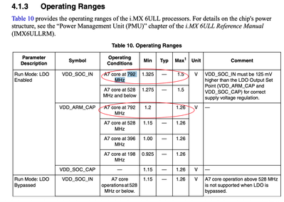

Zhiming_Liu
Hello @manux
Yes, the unsupported frequency is disabled. The chip on top of the EVK I tested yesterday supports 900MHz, and the EVK has to be designed to run at 900MHz.
The issue at hand is not whether the chip supports it or not, but whether the circuit design supports it or not.
1. The SoC requires VDD_SOC 1.325~1.5V and VDD_ARM 1.2~1.26V to run at 792MHz, but the on-board power supply is unable to stabilize the output or the current supply is insufficient.
2. High-frequency operation requires a higher degree of cleanliness of the power supply, excessive ripple may cause voltage fluctuations, affecting the core circuit. The current problem is not in the chip support or not, but the circuit design support or not.
It is recommended that monitor VDD_ARM or VDD_SOC with an oscilloscope during your test.
Zhiming

The VDD_SOC_IN is powered with a 3A voltage regulator (RT5753ALGQWA) set to 1.362V (measured 1.374V).
I was aware that the VDD_SOC_IN needs to be 125mV above VDD_ARM_CAP and VDD_SOC_CAP to operate properly.
Therefore theoretically VDD_SOC_IN is above the minimum 1.325V and VDD_ARM_CAP (1.362 - 0.125 = 1.237) is above the minimum 1.2V.
I use 3x10uF + 1x22uF capacitors the regulator output (recommended to be between 44uF and 66uF).
These capacitors are MLCC and I used 4 of them to have a low ESR.
For all the CPU decoupling capacitors, I use the same values as the EVK and are located very close to the pads at the back of the CPU.
All capacitors are high temperature rated and at least rated for 3 times the expected voltage.
Unfortunately I have no access to measure VDD_ARM_CAP or VDD_SOC_CAP with a scope.
As mentioned above all the decoupling capacitors are located on the back of the CPU on the bottom side of the board and the board needs to be plugged to a backplane to operate.

At least that what the "clk_summary" reports.
