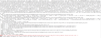

Hi NXP
Follow nxp github sop using Yocto 5.2
(1)U-Boot compilation fails on imx8mpevk using Yocto 5.2.
Send command :bitbake u-boot-imx.
(2) The documnet "i.MX Porting Guide" is wrong on Linux 6.12.20_2.0.0.
Your link is Yocto 5.1

Hi NXP
Maybe I lose install efitools.

Hi NXP
The document is already update and it is correctly.
But I send command :bitbake u-boot-imx  is still fail.
Please check it. Thanks.

Hi NXP
The question topic closed.

Thanks for the sharing, yes, efitools needs to be installed.
