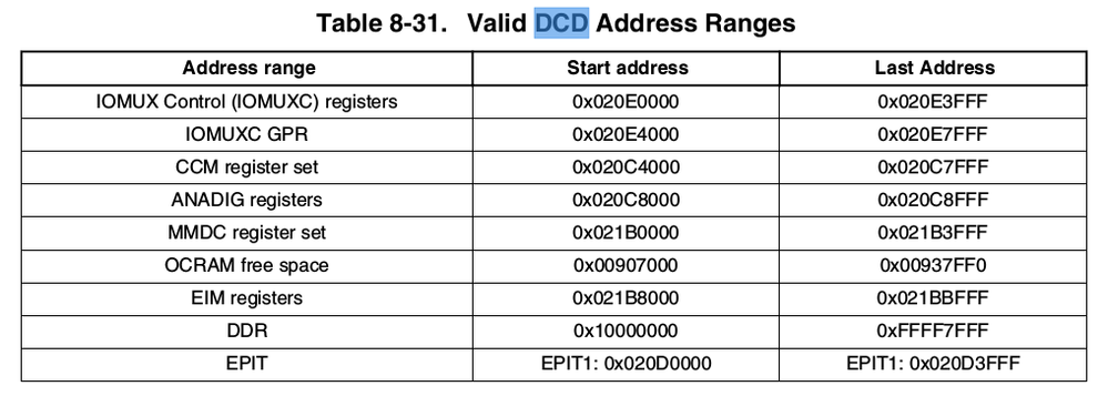

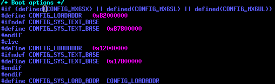

kinezo
Hi YuriMuhin_ng‌, thanks for the response. And sorry, was away for a few days.
As per the IMX6UL Ref Manual in Table 8-31, It seems I'm in the DCD range:
Also, from the u-boot src (from the fslc-2016-07 branch) TEXT_BASE is 0x87800000:
All seems to check out. Any other thoughts on why a 0x22 (HAB_INV_ADDRESS) error would occur?
11,767 Views
Yuri
  please check DCD table in U-boot code :
board/freescale/mx6<customer_board_name>/imximage.cfg
Yuri.
