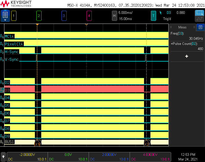

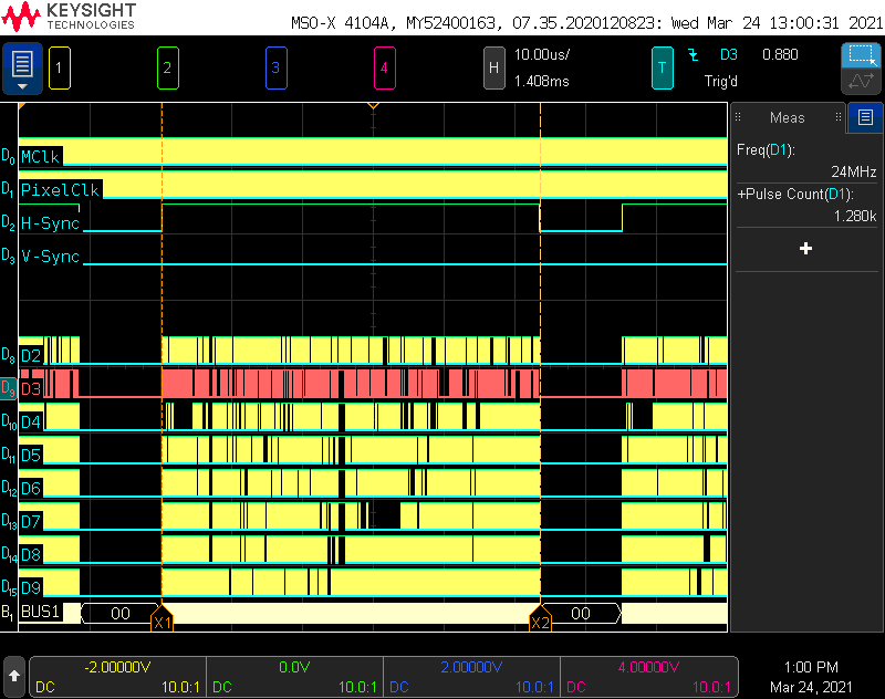

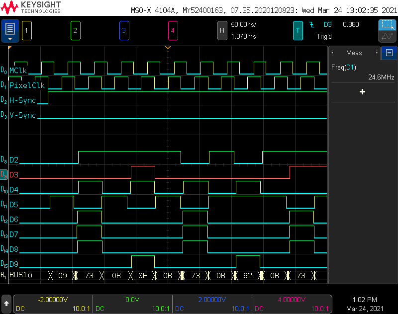

For security purposes, we are implementing our own camera driver in Op-Tee.
The sensor is connected to the CSI properly. My predecessor had this hardware working under Linux, using a hacked up Linux driver, but unfortunately his work got lost.
The sensor is configured with the same parameters as my predecessor did and it outputs 480 lines with 1280 pixels each. These lines are supposed to be alternating lines of BGBGBGBG and GRGRGRGR pixels, 8-bits each, on D2...D9. See attached oscillograms.
Question 1: Is the CSI aware of image geometry, treating different colored pixels differently, other than for statistic purposes?

I figured I'd start with small results, like receiving image data from the RXFIFO, but unfortunately it stays empty. No telling bits in CSI_CSISR are getting activated either.
What does work, is CSI.CSICR3.FRMCNT. This register field increases with 30 every second, as expected for a 30fps signal. So it clearly is receiving the camera signal.
Question 2: Why is no data being received?

Full frameFull frame
2nd image line2nd image line
First pixels on 2nd image lineFirst pixels on 2nd image line
