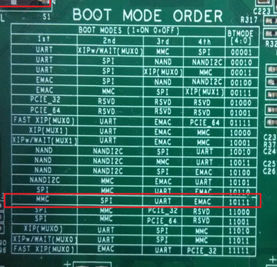

Hi, As we know that the TI chipset can be set boot device sequence(for example: the first device is SD card, the second is USB...the last device is eMMC).  The i.MX6Q has same function? if not, Could we know the boot device sequence diagram.  we have seen  the "i.MX 6Dual/6Quad Applications
Processor Reference Manual" chapter 8. But we didn't get the answer. please help provide related information for us.
below is TI boot mode order.

Hi hankwang
i.MX6Q has not same boot sequence function as TI chipset, sorry.
