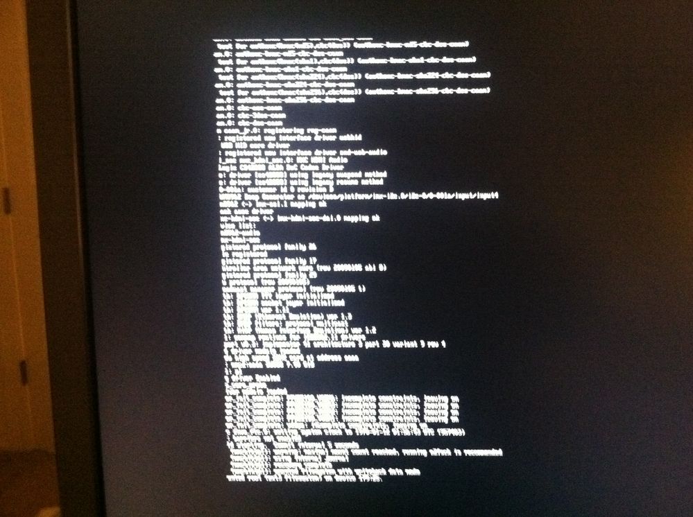

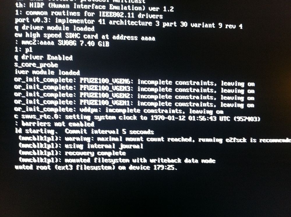

Greetings,
I'm having a little trouble with the i.MX6Q Sabre SDB board.  I have the board connected as follows:  an HDMI port cable to a large monitor (Dell 30" 2560x1600 native resolution), a USB terminal connection to a USB port on a PC, and a 22-pin SATA data/power connector running to a 2.5" HDD, and a USB keyboard plugged into the USB OTG port (using cable adapters).
I've also created an SD card with the binary uboot, kernel, and Ubuntu root file system which is what I'm trying to boot.
When I boot this system I get the following behavior.  Uboot comes up on the USB terminal connection and begins to boot.  The kernel then begins to boot and also dumps output to the USB terminal connection until the following output:
console [tty0] enabled, bootconsole disabled.
When I switch over to the HDMI screen, I see that the kernel is booting but I'm having trouble with the resolution.  It looks like the output is "too large" for the screen.  The first two or three characters on each line appear to be shifted off the left side of the monitor.  The output seems like its the end of the kernel messages but I'm not sure.  Then there's nothing.  The display does not continue.  There is no login prompt.  I don't have access via the USB terminal connection anymore and the USB keyboard does not appear to do anything.  I've tried playing around with the video= part of the boot arguments in uboot but have not had much luck so far.  I'm really just trying to get a terminal somewhere.  Should I try to ssh in via the Ethernet?
Can someone advise me on this?
FM

frankmiller
Screenshot # 2 of this
6,126 Views
frankmiller
Screenshot #1 of this
6,126 Views
frankmiller
Thanks for the reply.
1) I have looked at the release notes.   I've tried a quite a few combinations so far:
video=mxcfb0:dev=hdmi,1920x1080M@60,if=RGB24
video=mxcfb0:dev=hdmi,2560x1600M@60,if=RGB24
as examples.  I've tried this with just the one video and with two video entries (the other for mxcfb1).  I consistently have the same output.
Sometimes when I boot, the kernel output ends with this:
i mxc_hdmi: same edid
Note that I think two characters are cut off the front of this line, conssistent with the video problem I'm talking about.
2) There's the problem with video output but I'm also not getting any interactive prompt.  Am I right to assume the Ubuntu distro is supposed to dump you into a GUI environment with a login?  Is there supposed to be a login prompt on the text console?
3) The kernel does not appear to make use of the FTDI serial port.   It would be nice if this port was enabled by the kernel and a login prompt presented.
FM

daiane_angolini
Yes
As I remember, you can see a text console only if your kernel command line is configured to be dual display. You will see GUI on first and text console on second one.
Can´t you get any console (using any cable)?
6,126 Views
frankmiller
I'm not using the flat panel connections at all.  I don't even have a display to hook to them.  I have the system hooked up as I mentioned in the original message.  The output I'm seeing is U-boot displaying on the FTDI connection until the kernel boots, then the text output going to the HDMI port.  Then nothing.  I will say that I have not been using the second video= entry on the U-boot command line args.  Is the kernel wired to assume there is at lease one flat panel connection?  Is the GUI and/or serial connection hardwired into the kernel somehow?  Maybe I need to build another kernel?  Did you have any comment on the video issue?
FM
6,126 Views
daiane_angolini
Video issue:
Sorry for missing it. I have never saw something like that, and I don´t know how the digital video is messed (I saw something like that when displaying analog video on TV out)
I assumed you have tried any monitor offset configuration.
Are you using a HDMI cable or a DVI one?
For console. I don´t use ubuntu usually, so I don´t know the "commom behavior" very well. But I would expect that first display (GUI) would be displayed on any display.
In order to have your FTDI console to be displayed during kernel boot up I think you must enable it on kernel. I mean, rebuild kernel with TFDI console support.
