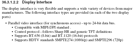

castel
Dear Weidong,
     thanks, we know the i.MX6 has no analog I/F to output video.
     so we did add a DAC "ADV7391" (like the CH7026 you mentioned, but the former is much simpler because it only accepts BT.656, the cheapest TV encoder), a CVBS encoder to convert BT.656 to analog(525i/625i).
     But we don't know how to set DI format to BT.656 though the manual say YES as follow, and we've tried some setup in bootargs(wroten on top) but no effect.
