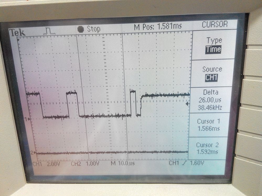

Hi All,
Serial driver version: patched up to 4.1 (except for RS485 parts)
The error happens when the device connected to the serial module starts-up and sends a break signal.
The code endlessly loops at the code below, with USR2_RDR always on,
0xFF on the the RXD data register with no error bits.
while (readl(sport->port.membase + USR2) & USR2_RDR) {
Although 0xFF is being read on the data register, the connected device is not sending any signal
as checked from the oscilloscope.
Best Regards
Yuri

maxim1
I have the same problem!
linux 4.9.14
DMA is disabled.
UART speed 307200, 8n2.
The imx6 receive 10 zero bits and fixes the FRAME error.
Next, the imx6 receive a short start bit (1.2 usec) and goes nuts.
The processor starts to accept infinitely 0xFF.
Helps only software reset uart.
URXD0 = 80B9
URXD0 = D000 - FRAME error
URXD0 = 80FF
URXD0 = 80FF
URXD0 = 80FF
URXD0 = 80FF
Photo of oscillograph.
If the processor receives the normal start bit (3.2 usec), then there is no problem.
URXD0 = 8007
URXD0 = 80FF
Path imx.c:
  if (unlikely(rx & URXD_ERR)) {
+     if (rx & (URXD_BRK | URXD_FRMERR))
+         imx_software_reset(sport);
      if (rx & URXD_BRK)
+static void imx_software_reset(struct imx_port *sport)
+    unsigned long temp;
+    int ubir, ubmr, uts;
+    ubir = readl(sport->port.membase + UBIR);
+    ubmr = readl(sport->port.membase + UBMR);
+    uts = readl(sport->port.membase + IMX21_UTS);
+    // Clear the SRST_B bit (UCR2[0])
+    temp = readl(sport->port.membase + UCR2);
+    temp &= ~UCR2_SRST;
+    writel(temp, sport->port.membase + UCR2);
+    // Wait for software reset complete: poll SOFTRST bit (UTS[0]) until it is 0.
+    while (!(readl(sport->port.membase + UCR2) & UCR2_SRST))
+        barrier();
+    // Re-program baud rate registers: Re-write UBIR and UBMR.
+    writel(ubir, sport->port.membase + UBIR);
+    writel(ubmr, sport->port.membase + UBMR);
+    writel(uts, sport->port.membase + IMX21_UTS);
7,305 次查看
Yuri
   You can try the following patch
kernel/git/torvalds/linux.git - Linux kernel source tree
Looks like this is known issue, You may create request for more details.
Sales and Support|NXP
Yuri.
