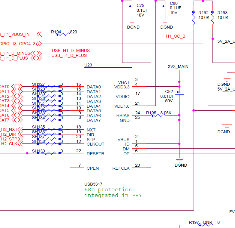

Sabre for Infotainment includes a USB Transceiver IC as can be seen in the schematic snippet below;
Why is there a need for the USB3317 IC? Is it perhaps because there are 2 USB Host connections in the
Sabre design? Am I misinterpreting the datasheet when it says "USB support is composed of USBPHY (HS USB
Transceiver) ?
Thanks in advance for any replies.

igorpadykov
Hi Atilla
USB3317 is not used with i.MX6, it is used with i.MX53 as
SCH-26662 is common board for both processors.
USB HSIC transceivers may be used with i.MX6 HSIC interface
like : USB_H3_STROBE,USB_H3_DATA signals.
igor

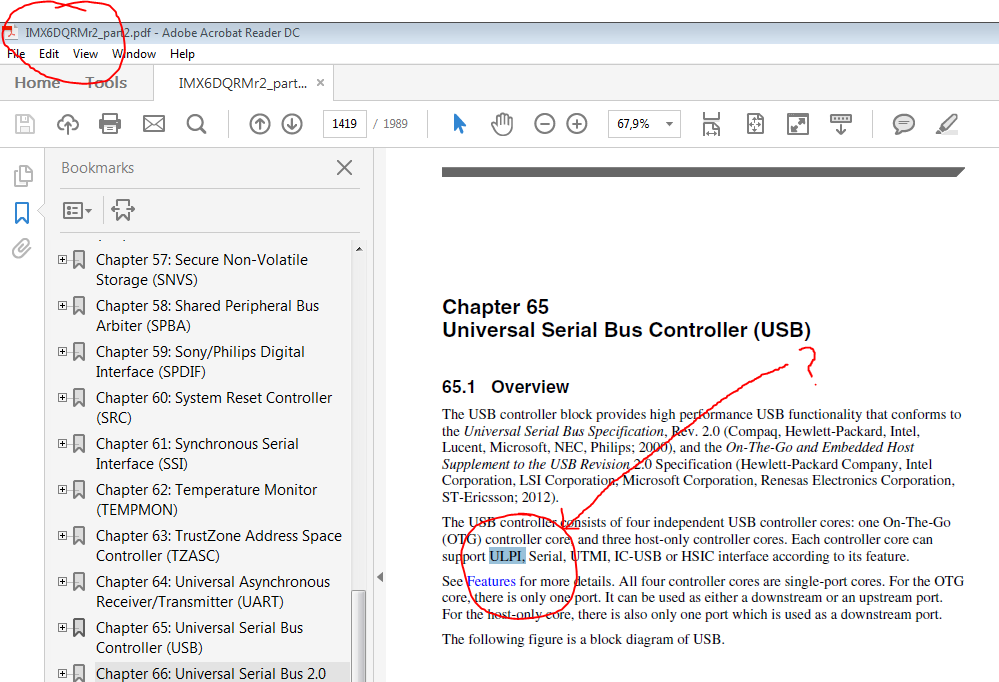

Dear Igor,
Okay you are really making me confused, here is a screenshot from the iMXDQ Referrene Manual;

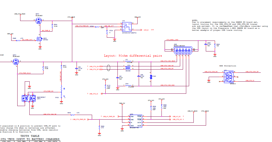

Also there is nothing related to USB on page 3 of SPF27392
On page 11, USB OTG conenction is shown only.
So please give me a detailed answer on this so we dont waste more time on this subject:
On a custom hardware using iMX6Q, what do I need to do in order to connect a USB Type A
so I can make my device USB Host. Please dont mention HSIC again, I cant use the HSIC ports
for that purpose.

igorpadykov
Hi Atila
for USB Host one can look at p.11 attached schematic.
USB module supports ulpi transceivers, but in i.MX6 ulpi signals are
not routed externally.
igor
