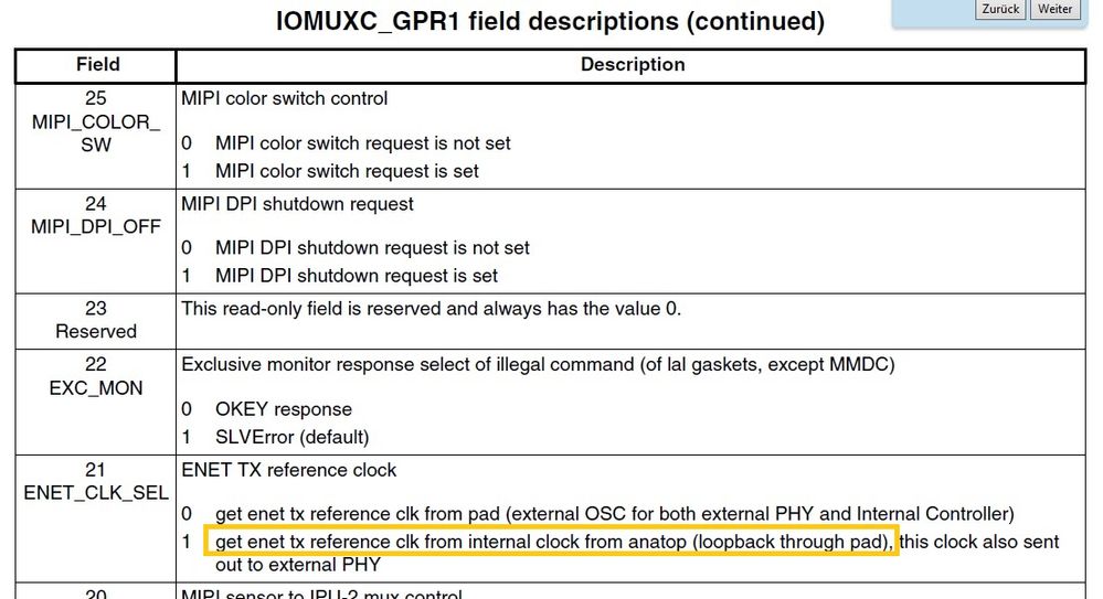

I would use the internal clock for RGMII. The external Switch have no clock reference, because the 12 wire RGMII interface dont't support that.
configuration clock: (like Hardware Development Guide)
CCM_ANALOG_PLL_ENETn                        - 125MHz
ENET_CLK_SEL                                         - get enet tx reference clk from internal clock from anatop (loopback through pad), this clock also sent out to external PHY
IOMUXC_SW_MUX_CTL_PAD_GPIO16    - ENET_REF_CLK(signal)
It is possible to use ENET_REF_CLK(pad) then as GPIO ?    (IOMUXC_SW_MUX_CTL_PAD_ENET_REF_CLK)

Hi Mathias,
Unfortunately there's no way to route the 125MHz clock internally like it is the case for the 50MHz one. The 125MHz clock has to be output at the GPIO16 and then routed back to the ENET_REF_CLK.
Best regards.
Jorge.
