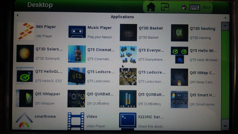

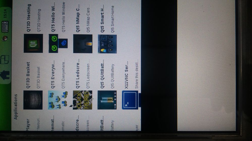

ambika
Hello Frider  Schrempf,,
Thanks for the driver file.
It helped me out and rotation is working with my kernel source also.
But with 90 degree rotations (4 to 7) the display will be cropped. I have attached two images.
rotation = 0 (none)
rotation = 7(90_left)
I work on 800*480 resolution display. Whether support can be done for h*w resolution where h=w?
What can be done to support all resolutions (less than 1024*1024) to see the rotated screen completely?
Thanks in advance.
Ambika
