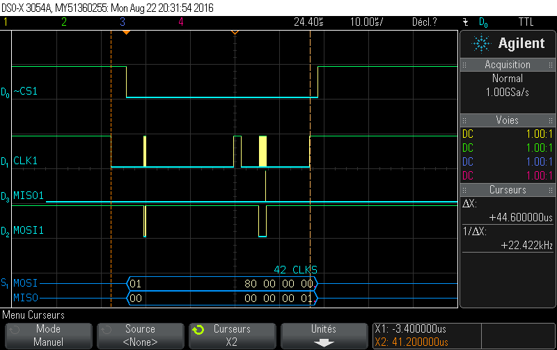

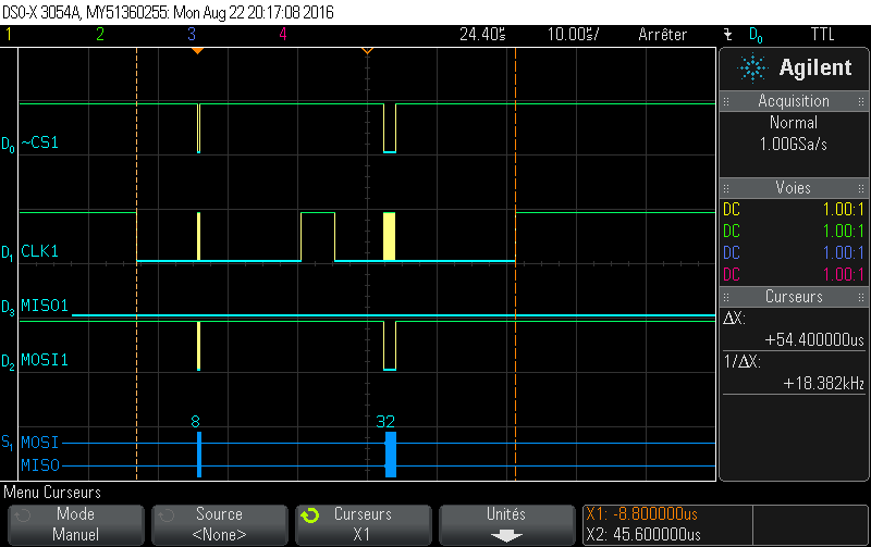

First, here is a capture of two SPI transfert in one SPI message :
Issue 1 : CS have to stay enabled between 8bits address writing and 32bits value reading.
Even if I set explicitely cs_change to 0 in my kernel driver, CS is disabled between the two bursts. I assume that I have to set SS_CTL to 0 but I have no idea how to do that in my driver
Note : If I change CS from SS0(DISP0_DAT18 - ALT2) to GPIO5_IO12 (DISP0_DAT18 - ALT5) this CS issue disappear - see oscilloscope print bellow - but I'd prefer to use native ECSPI CS.
Issue 2 : Why Is there a CLK tick between the two SPI message?
This issue is the same than the one describe here : https://community.nxp.com/message/625531#comment-625531 but solution have not been found yet.
Issue 3 : Time to take / release SPI communication is huge
As you can notice in the oscilloscope prints the time to take / release the SPI communication is really disappointing. I assume this is because SPI communication is handled by the kernel instead of the ECSPI bloc. Is there any way to change that?

Hi Julien
1. "cs_change" is not used in nxp ecspi driver (please check attached
Linux Manual Chapter 37) and sources/dts documentation :
http://git.freescale.com/git/cgit.cgi/imx/linux-2.6-imx.git/tree/Documentation/devicetree/bindings/s...
http://git.freescale.com/git/cgit.cgi/imx/linux-2.6-imx.git/tree/drivers/spi/spi-imx.c?h=imx_3.14.52...
In general one can add support for it using "of_get_named_gpio" in  spi_imx_probe()
function. To avoid CS disabling between the two bursts it is necessary to set ECSPIx_CONREG
BURST_LENGTH with data burst and provide algorithm to avoid emptying TX FIFO, untill
all bits data sent out.
2. issue was not confirmed by nxp expert, in particular one can pay attention to
ERR009606 eCSPI: In master mode, burst lengths of 32n+1 will transmit incorrect data
3. timing may be affected by OS overheads, so one can try to optimize it removing
unused modules and tasks with heavy graphic.
4. set ECSPIx_CONREG[BURST_LENGTH] for 40 data burst and provide such algorithm
so TX FIFO was never empty, untill all data sent.
Note, NXP has service for helping customers with porting drivers:
http://www.nxp.com/support/nxp-professional-services:PROFESSIONAL-SERVICE
Pro-Support contact www.nxp.com/prosupport
igor
