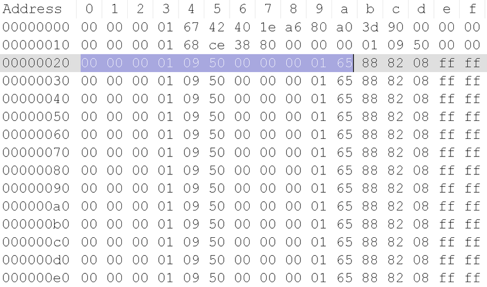

I use VPU to encode  raw nv12(640x480) to h264.
After check the first 16 bytes of every encoded frame data, I find they are all "00 00 00 01 09 50 00 00 00 01 65  "(all I frames), But I have set the gopSize to 30.
The attachment is the output h264 which is static sceen, you can use VLC to play it.
My question is:
How to enable interframe compression?

Sloved!
I make a mistake on CMD_ENC_PIC_OPTION(IdrPic) in code.
