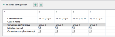

What is channel group on ADC?
I can' t find out in the i.MX RT1060 Processor Reference Manual about it.
But there is on MCUXpresso Config Tools and SDK functions.
What is the relation ship with ADC1/2 moudle and ADC external signals (pins)?

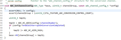

The RT1060 family has two ADC modules, ADC1 and ADC2, each module has 8 channel groups. These channel groups correspond to registers ADC1_HC0, ADC1_HC1,  ADC1_HC2,  ADC1_HC3... and ADC1_R0, ADC1_R1, ADC1_R2, ADC1_R3... The same applies to the ADC2 module.
I understand your point. With the current information of the reference manual, it's confusing to know what are the channel groups. I will pass these comments to the documentation team.

I undersatnd that each ADC modules has 8 channel groups.
So, these 8 channel groups, each could have several ADC signal, like below?
I want to use PWM and ADC in synchronization.
In this case, is the ADC done in group units?
I want to know about the relationship of group and signal.
Yes, your understanding is correct. There's only one thing to keep in mind. ADC_HC0 can be used for both software and hardware trigger mode. Other ADC_HCn (n = 1...) are for use only in hardware trigger mode. For more information regarding this, refer to section 66.8.1 of the reference manual.
You have to use these registers, ADC_HCn, no matter the functionality.
