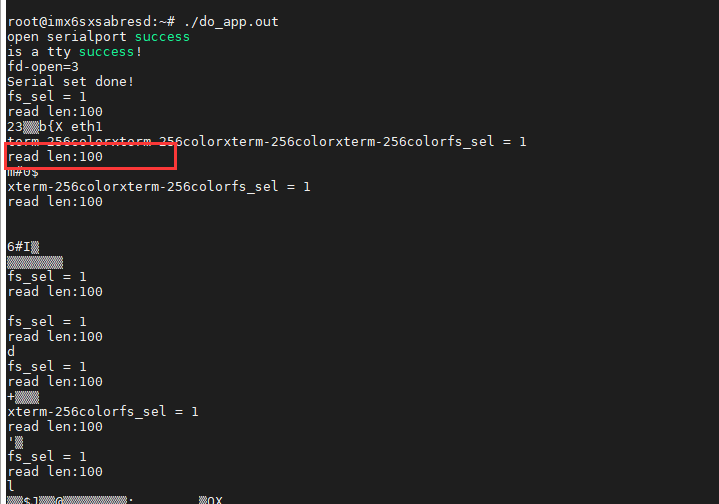

Hello,everyone
Recently, I am using the imx6sx serial port for debugging, using other serial ports, and writing an application program to read data, and use other upper computers to send. After the kernel is fully started, the application program is executed first and then the serial port host computer is used to send data, which can be obtained normally. But I first used the serial port host computer to send data and then started the board and opened the application program. I found that the data were all garbage values, and the number of bytes was also defined as the largest. After a while, the number of bytes became 0, and there was no data. It is normal after restarting the application several times.

2548903578
Hi,igo
     I have found the reason, because the sdma method used by the serial port, our board failed to load the sdma firmware when it was started. So I failed to run the software directly after entering the file system. However, after a minute or so, the firmware will be successfully loaded again, and there is no problem in running the software afterwards.
