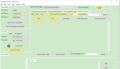

  Do you enter the serial download mode, and connect it?
  Please share me some screen picture about the MCUbootutility connection and read, and erase.
kerry

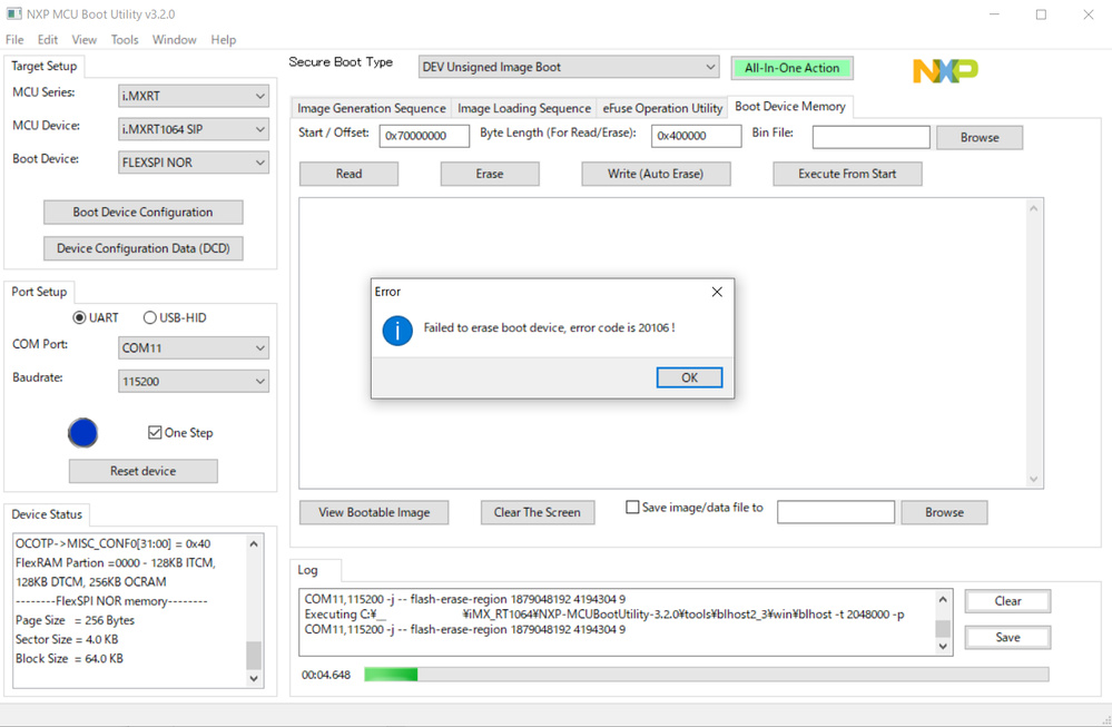

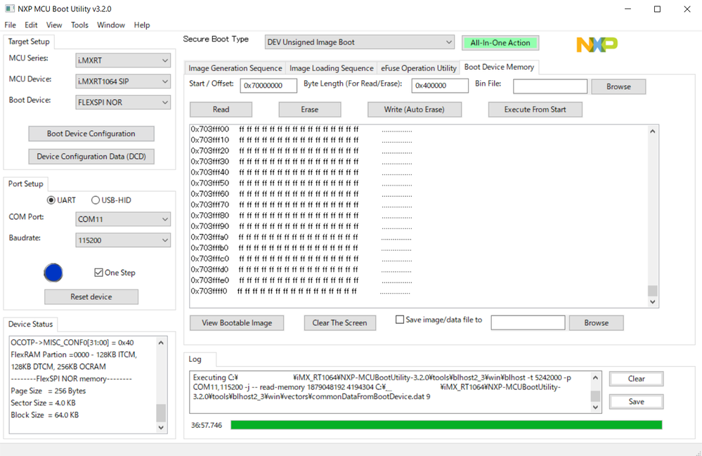

hiro33
Hi Kerry
I took pictures.
-read is OK
-erase is NG
Best Regards
