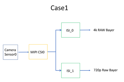

Application Note: AN13430 "i.MX 8MP Dual ISI channels for single CSI" explains how to use two ISI channels connected on single CSI port.
I would like to do something similar but instead of using two ISI channels, I would like to use ISI and ISP like this:isp_plus_isi.pngFollowing AN13430 I achieved some success but the imx8mp crashes when stopping one of the pipelines (ISI or ISP). It seems the stop is propagated to physical CSI which causes the crash.

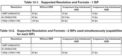

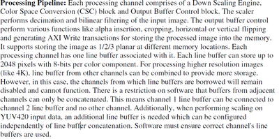

However I am not using ISI_0 at all (I am using ISP_0 and ISI_1 ), so the line buffer can entirely be used by ISI_1.
What I heard though is that one cannot use 4K on both ISP channels. Not sure this is true, but I can imagine it is.

>>but, I also test and receive 4K x 2ch each 15fps
This is very very interesting. You are saying you managed to run 2 ISPs in parallel at 15fps each like this:
Can you confirm please?
According to RM below I thought this would not be possible.

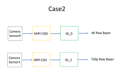

Can you please elaborate. Which case do you want do do, case1 or case2?
Case1: is possible. explained in NXP AN13430.pdf - i.MX 8MP Dual ISI channels for single CSI
Case2: Should be regular case. I don't see any problems here

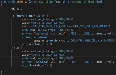

If we use 4K on ISI_0, chain_buf borrow ISI_1's line buffer.
So,  ISI_1 could not use Line Buffer.
Also, I tested several method, but Streams Image changed to all greens.
Could you explain more how to open case2's streams, please?

ISI_1 (ordered by ISI_0, ISI_1)  can not treat 4K.
